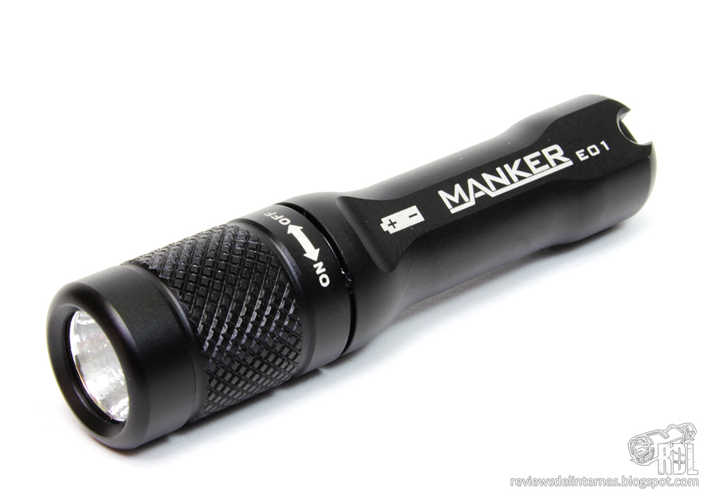

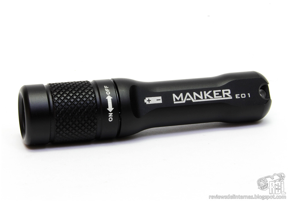

The exterior design of this flashlight is quite original, because of its rounded shapes and slight oversizing gives it a very own distinctive aspect.

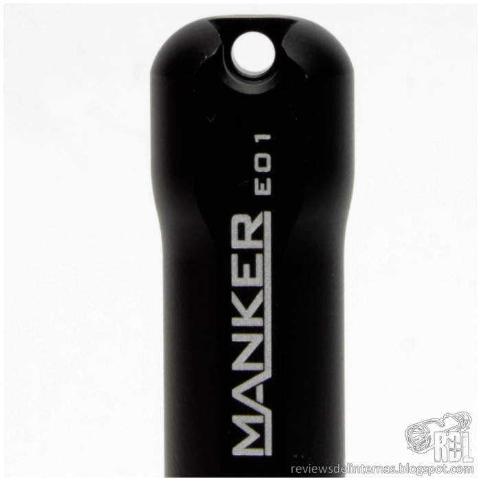

It is machined in anodized aluminum with very nice matte finish, and has some very well-defined and easy to read engravings thanks to the high contrast obtained between the black background and white graphic. In addition to the brand and model, we have an indication with the correct polarity of the battery as well as another indication of the mode of use, all very basic.

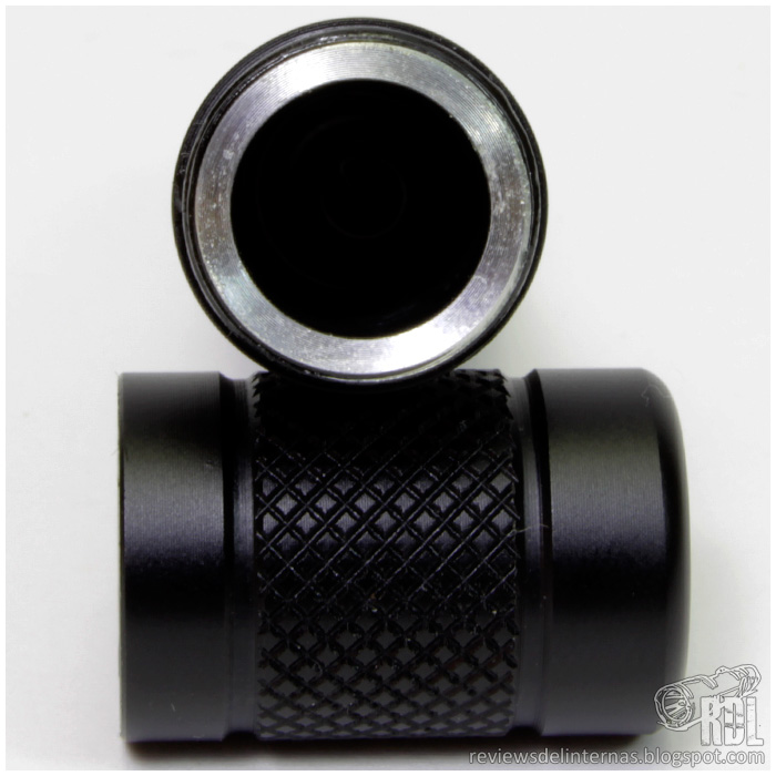

The head of the flashlight has substantially larger diameter than the rest of it, and has a generous strip of knurling which greatly facilitates the grip of the head to make use of the twisty. The bezel is flat, with generously rounded edges.

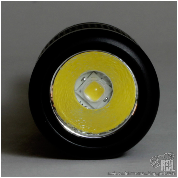

The optics of this small Manker is composed by a OP reflector and Nichia 219C LED with neutral tint, properly centered, and all topped off with an AR coated glass lens.
The walls of the flashlight, especially in its connection between the head and body have a very generous thick. The driver disk is covered by a foam ring, which prevents the typical battery rattle when the flashlight is off, and in addition it also works as a mechanical protection system against wrongly installed battery (reverse polarity).
The threads are anodized, and arrive well bathed in lubricant from factory, as well as the o-ring. Twisty action is quite smooth.
The tube design is quite peculiar as it has “two volumes” but maintains a smooth design, with smooth curves at both ends. Tail design, also rounded, has a large hole to put the split ring. Machining surrounding it has some sharp angles. Of course, with a design so rounded the tailstand of this flashlight is stable at all.

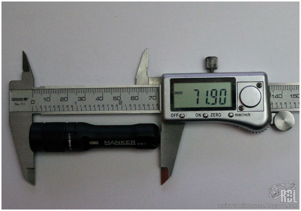

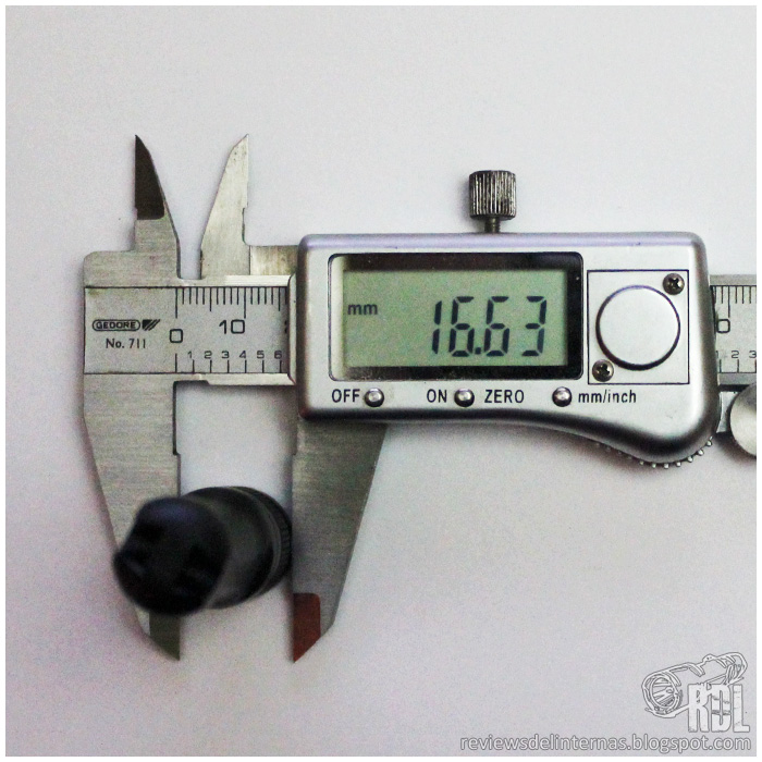

Dimensions and very similar to the average in this type of flashlights weight.

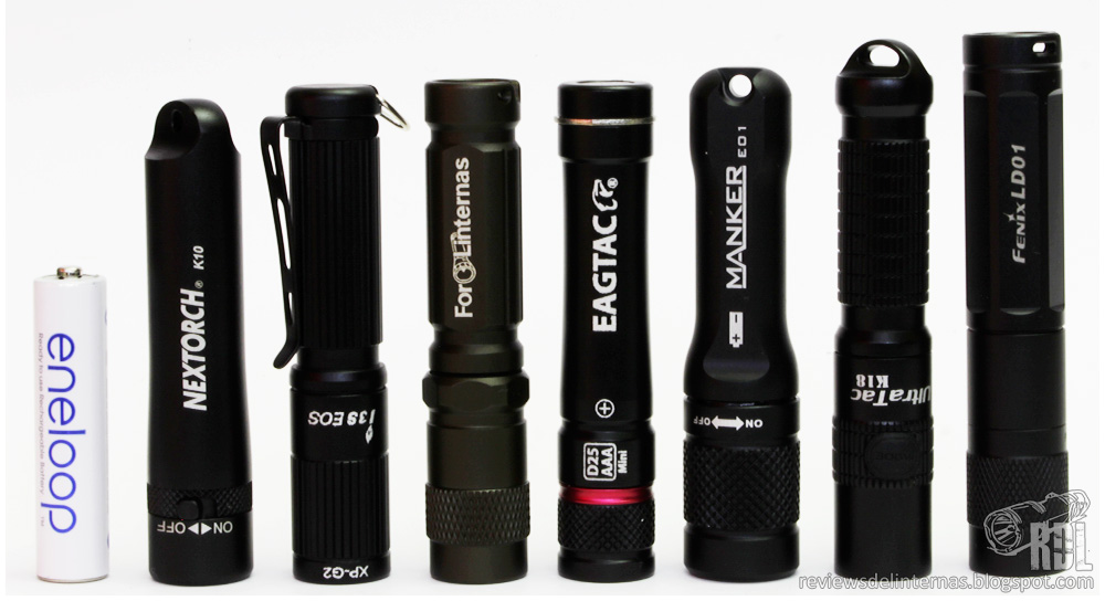

Performance in Hight mode with AAA Eneloop is quite discreet, with a smooth curve in which most of the time we move between 70 and 80LM.
Compared to other flashlights AAA, this E01 is not particularly outstanding nor maximum output nor for runtime. Click here for a view the image in higher resolution.

The Nichia 219C is undoubtedly the hottest point of this Manker, since it is difficult to see such emitter in a mass produced flashlight.
The projection is very good with a medium-large hotspot well faded with spill with no artifacts or darker areas in the area surrounding the corona.
Although the Nichia LED is slightly behind at maximum output or efficiency versus CREE alternatives, such the XP-G2, the Japanese manufacturer Nichia emitter offers a higher CRI (Color Rendering Index), so it is able to reproduce illuminated colors in a more reliable way or closer as sunlight would do.

Nextorch K10 · Olight i3S EOS · Tank007 E09 · Eagletac D25AAA Mini · Manker E01 · Ultratac K18 · Fenix LD01
Negatives: The E01 is a slightly over-sized flashlight, with a head that is somewhat larger in diameter and perhaps wasted space. The performance and efficiency of its High mode is poor compared with other similar single AAA flashlights. The spacing of the modes is a bit quirky, and the default activation mode may be too low for most situations.

This is not 219C, but 219B
UPz (16.03.2016)

да, выглядит как 219В (впрочем, живых С-к не держал пока в руках).

Hemi, Да, В (хотя на 1-ом Вашем фото, вроде как "А"). Спутать С с А и В по внешнему виду невозможно.

YES, I know it's not a 219C, but that's what manufacturer states in the user manual and website. I've told them about, but they keep telling that the stated nichia code is correct.
