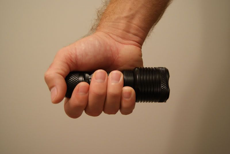

The first graph is of OTF lumens using CR123 primary batteries and holding the light in what I call a 'regular' holding position. This is how I expect most users to hold this light while in use. Here's an example of how I'm holding the light(the S18 is certainly larger than the X10 in the images, but it gives you an idea ). Click either of the two images for full size:
