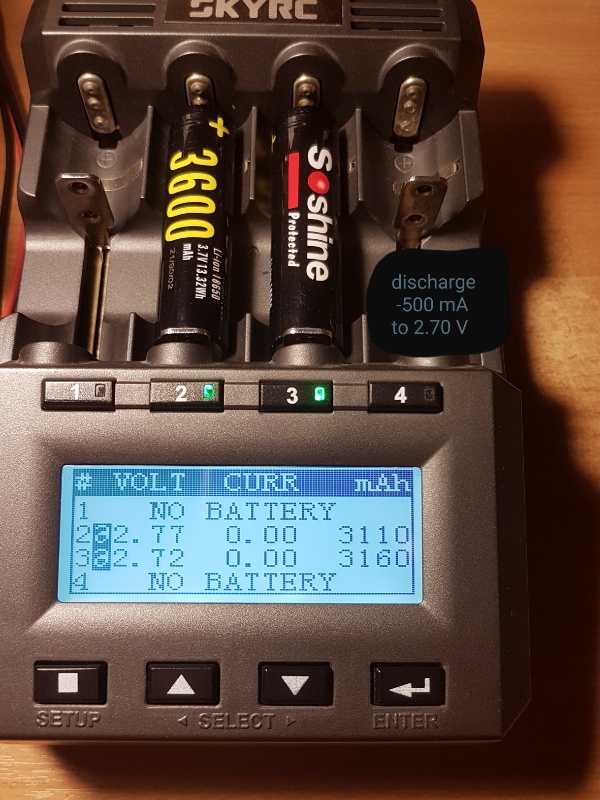

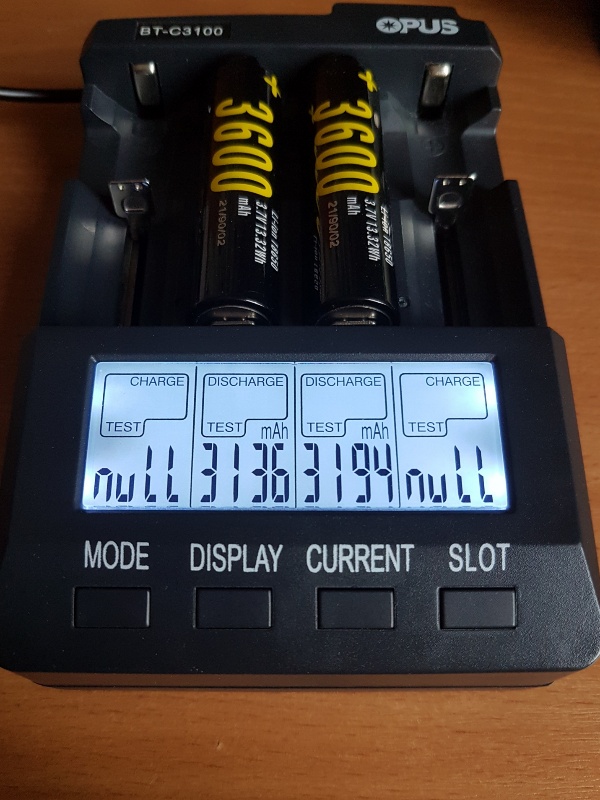

I don't know, why u wrote in resume positive words...
I do not think so! The capacity Soshine 3600 strongly not high, not full etc...
And new version too:
Kruglerman вне форума   Ответить с цитированием Вверх
