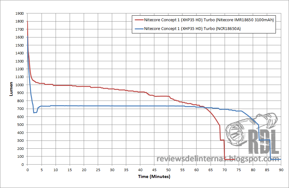

This new family of high-output LED emitters needs, as it could not be otherwise, batteries capable of delivering steady high currents. That is why Nitecore recommends the use of an IMR battery or, failing that, one that is capable of delivering a constant discharge of 6 amps. In my case, I have tested the flashlight with several batteries and I have been able to see how with the typical protected batteries the flashlight is unable to reach the Turbo mode, and either shut off by the battery circuit or automatically go back to the low mode.
For the usual test in the mode of maximum performance I have used an IMR18650 of those Nitecore markets for its TM28, and to check the difference I have repeated the test with a common NCR18650A. You can see how the discharge curve is quite different between both batteries: The IMR offers a much higher initial output, and seems to maintain a constant struggle for not lowering a mode, while the Panasonic three minutes after activation is no longer able to supply the necessary power and seems to stabilize at an intensity around 730lm. The difference in behavior between the two batteries is probably because the IMR is the thermal management that decides the maximum output of the flashlight, while with the NCR18650A is decided by the voltage of the battery.

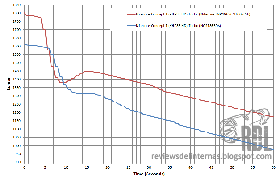

In this zoom view (at the maximum resolution that my measurement and data-logging instrument allows me) we can observe the behavior of both batteries during the first minute of continuous use. Both curves show a curious little bump around the seventh second, that the IMR seems to try to overcome it. Curious…

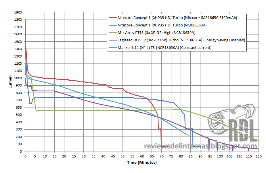

Compared to other high-performance compact flashlights, the Concept 1 seems to benefit from the extra efficiency its XHP35 offers versus the classic XM-L2 or XP-L.
