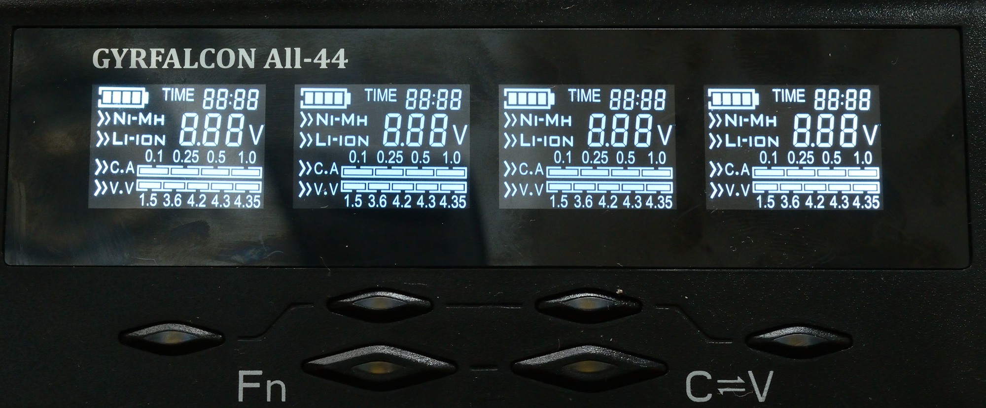

The full user interface with 4 readouts and 6 buttons, one for each slot and two special buttons. All buttons has a leds in them.
The slot buttons will show a blue led while charging and a red led when done.
The display has many elements on it, because the charger can handle many types of cells.
Depending on mode not all the elements are used.
First image is manual mode and second image is automatic mode (No block or marker for VV line). Hold down Fn and CV for some seconds to change mode.
In automatic mode the slot buttons is only used to change current, selection of voltage and starting is automatic.
In manual mode some more button presses are needed:
