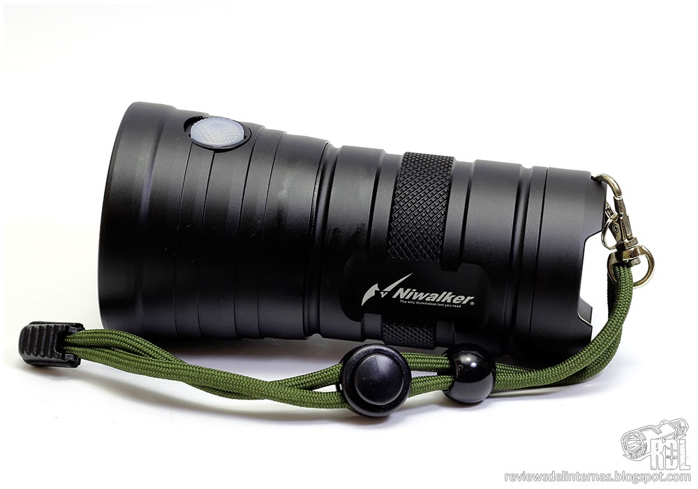

This is a compact flashlight of very high performance, where in the approximate size of a soda can they found room for three XHP75 LED emitters powered by four 18650 batteries.
The chassis of the flashlight is made of anodized aluminum in black, with a very elegant matt tone and conveying a rough and comfortable feel to the touch.
The machining lines are discrete, with no sharp dissipating fins or edgy angles.
The flashlight is really compact, with a total length of 130mm, a maximum diameter in 64mm at the optics and a weight of 389g (without batteries).
The optics are composed of a steel bezel with sandblasted finish, an ultra-clear crystal lens with anti-reflective coating, a triple OP (orange peel) reflector and its respective three CREE XHP75 LED emitters, all perfectly centered thanks to the use of a specific centering mechanism. The non-practicable area of optics is “decorated” with a black adhesive, giving it a very personal touch.
The reflector has small dimensions, partially overlapping the surface that each of the emitters uses to bounce the light. The orange peel texture of the reflector is quite marked, to surely blur to the maximum any type of aberration that the XHP70 could produce.
The head of the flashlight has a digital switch covered by a semi-translucent silicone button, which allows the system indicator light to pass through it.
The switch protrudes slightly from the profile of the flashlight, making its location much easier to touch.
The threads are completely anodized, and have a trapezoidal finish arriving perfectly clean and slightly lubed.
The configuration of the battery holder cartridge is 4S1P, and with the contacts on both sides of the cartridge, so it is indifferent the orientation of this inside the flashlight. The space for the batteries is enough to accommodate protected cells without problems. A small stud in the positive contact area allows the use of flat-top batteries without problems.
The springs have a really thick section, with considerable tension. The overall construction of the cartridge is good, similar to the one we saw in the Vostro family time ago.
The central tube has a small knurling track, and in two longitudinally opposite planes we find the only two laser engravings, both perfectly defined and easy to read thanks to the white text on a black background.
Finally, the tailcap of the light, integrated in the central tube, allows to place the light in tailstand in a stable way, and also provides two clear anchor points for the wrist strap or any other hanging accessory.
