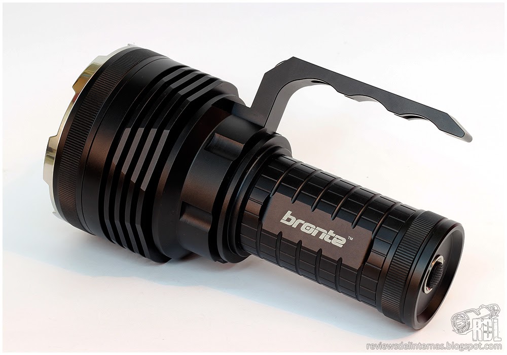

The Bronte BT41 is a high performance flashlight, and it shows in their size and weight.
With a maximum diameter of 96mm in his optics, a total length of 190mm and weighing 1015g (~1200g with four 18650 inside), we have a flashlight with considerable dimensions and weight while maintaining a compact and not overly long design.

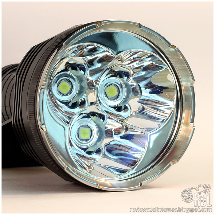

Optic end is protected by polished steel crenellated bezel, a glass lens and a huge triple smooth reflector, in which each of the cones overlap slightly with the other.
The huge emitters are slightly offcentered, but given the nature of the beam profile of this flashlight it will hardly affect in practice.
The head is equipped with striking dissipating fins, which also are recessed forming flat spots that prevent the flashlight from rolling if it is deposited on a smooth surface.

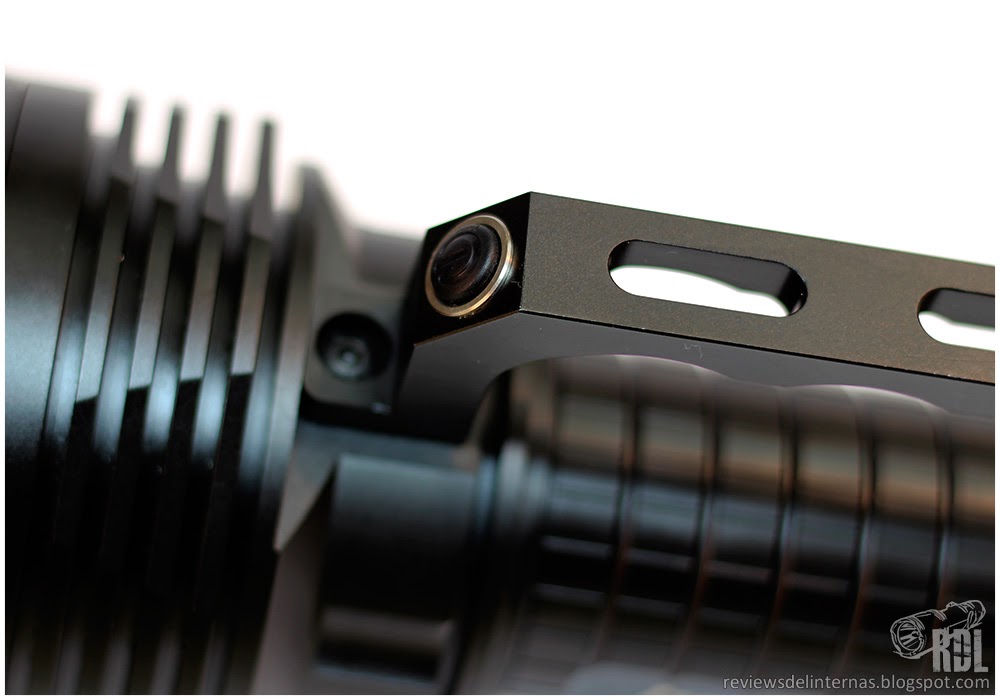

The handle has an ergonomic design and is comfortable to hold and operate. Located at the top end we find one of the switches, which is very comfortable to operate due to its natural position.
The handle can be removed easily, you just have to remove an M4 allen screw and pull, since the switch connection is mechanical / magnetic.

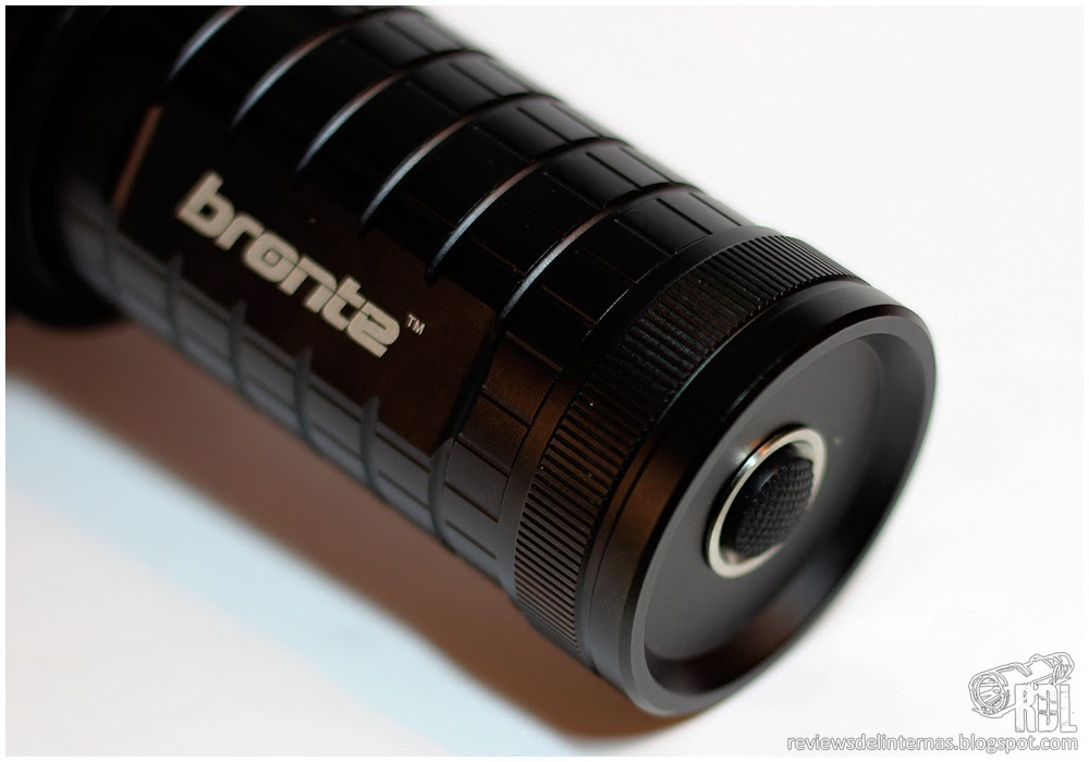

The flashlight is anodized black, brilliant. Only two engravings found on the flashlight, both in the central part of the tube, and both very well defined. The central tube has a rectangular knurling finish, quite showy but ineffective to improve the grip of the flashlight.
The tailcap is the only removable part of the BT41. Threads are cut square and shown in crude, clean and lightly oiled finish.

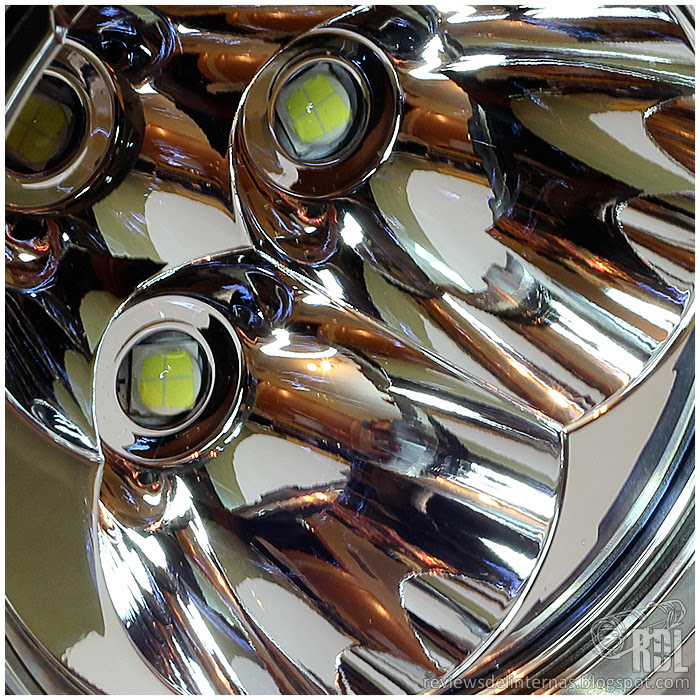

As you can imagine, the combination of triple XHP70 (which already is a kind of LED with four emitting surfaces inside) at any flashlight will have a marked flooder character. Still, Bronte has accompanied this CREE emitters with a smooth reflector, probably looking for a more defined beam effect.
The result? A huge hotspot which, together with the vast amount of light produced, requires the highest shutter speed to be “intuit” in my classic against the wall shots.
The tint is cool white, very similar to that found in other last generation cool white CREE, with that typical greenish-yellowish tint in the area surrounding the hotspot.

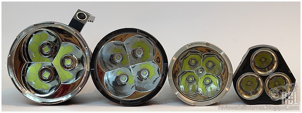

Bronte BT41 · Nitecore TM16GT · Fenix LD75c · Manker Godmes
