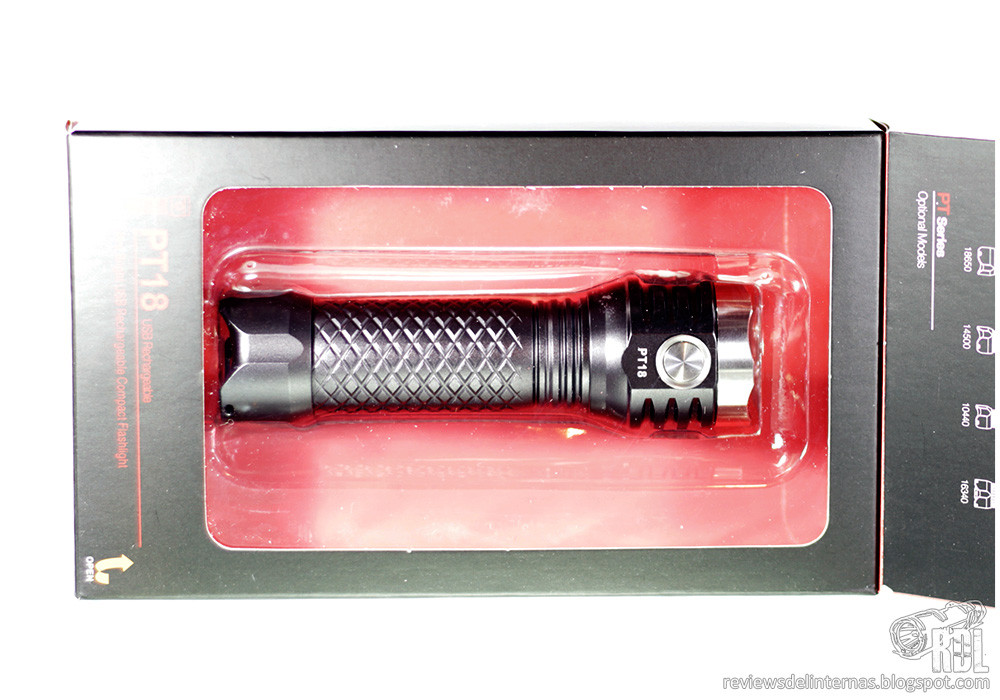

The presentation of the flashlight is very interesting. The box that comes has a front flap that can open to show, through a plastic window, the flashlight inside the packaging.
Inside we find the flashlight accompanied by a few spare o-rings, paracord wrist strap and user manual (generic for all models of the PT range) in English.

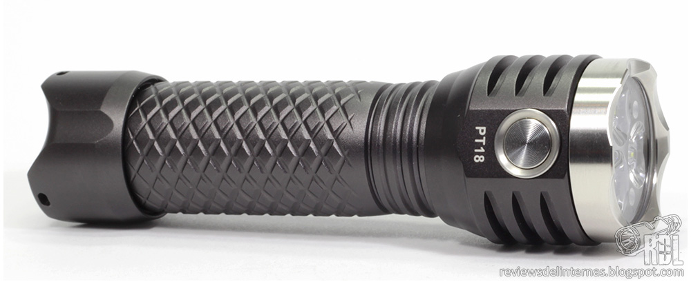

The MecArmy PT series has a similar appearance throughout its range, changing only the size of the tube housing the battery while maintaining a unique design.
The PT18 is machined in aluminum with an anodized finish in dark gray rather special, because it is not the classic gray “gun metal”.

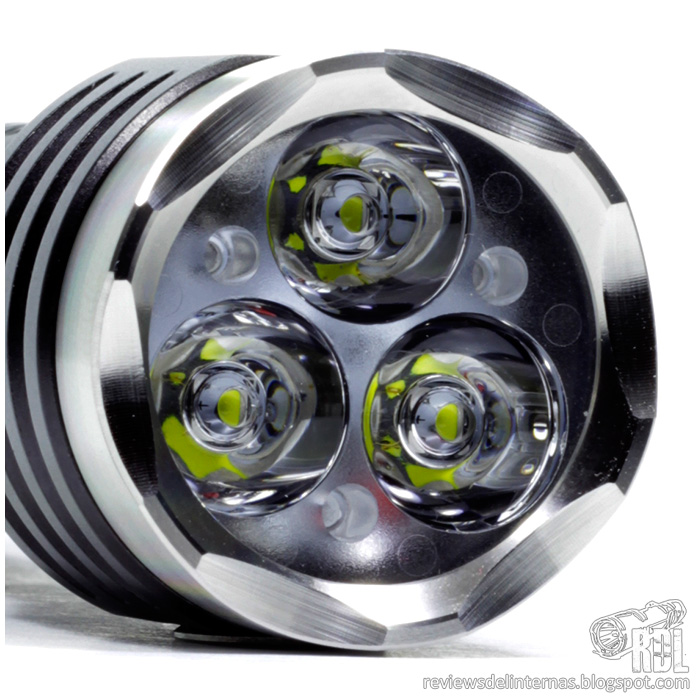

The head of the flashlight is slightly oversized to accommodate the triple lens perfectly.
It has a crenelated stainless steel bezel, which held in place a triple TIR lens for three CREE XP-G2 emitters.

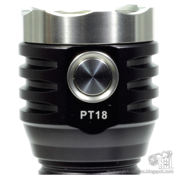

The head is surrounded by discrete dissipating fins, machined with two diametrically opposed flat where one of them features the switch, which is finished in stainless steel matching the bezel finish.
The threads hide in its lower part the microUSB port for recharging the flashlight without removing the battery or use an external charger. The threads have a trapezoidal cut, and are anodized making it possible to block the flashlight through a mild unscrewed.
The tube has a rather peculiar finish with a smooth and not very aggressive rhombic knurling.
The tailcap of the flashlight is also slightly oversized, and has a stable base that allows us to put the flashlight in tailstand safely. The three tailcap battlements are perforated to provide an anchor point for the lanyard.

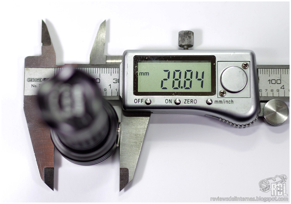

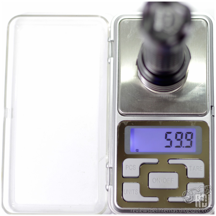

The dimensions and weight of the flashlight are surprisingly low considering that it is a flashlight with built-in charger.

  • ON and OFF: The MecArmy PT series is activated by a simple click on the digital switch located on the head. To turn off simply make another simple click on the switch.

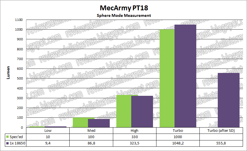

The distribution of intensities is good, with 10, 100, 330 and 1000lm spec’d lumens. The Low mode, with its 10lm, is really suitable for a default on indoors. Turbo mode has a time-controlled stepdown, coming down from the initial value to about 550lm. The correlation between specified by the manufacturer and measured in the integrating sphere is very good.
Unlike as we saw in the SGN3, this PT18 modes are achieved by regulated current with no signs of PWM.

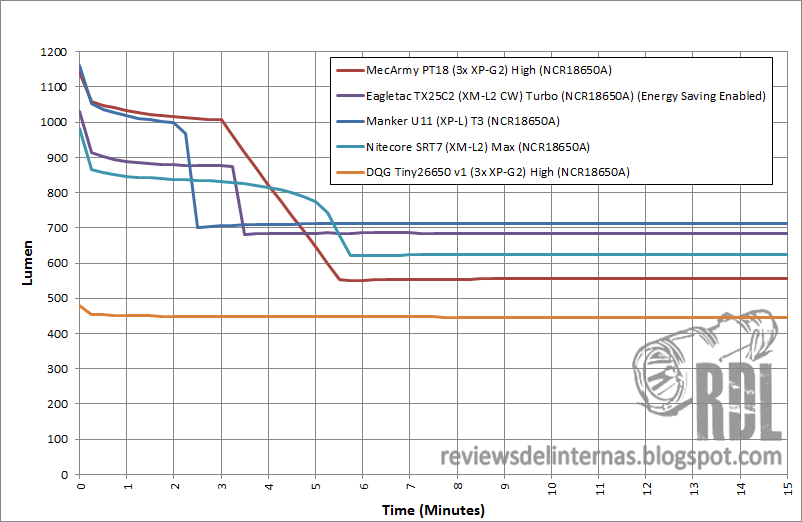

PT18 performance in its Turbo mode is pretty good. This mode has a time controlled output stepdown which reduces the flashlight output past three minutes from ignition to protect it from overheating damage. Once reduced, output is maintained until the time when the voltage is insufficient and starts a gradual drop in performance without turning off the flashlight abruptly.
To check the difference between the supplied battery (“2600mAh”) and a NCR18650A, and incidentally to compare equal this flashlight I repeated the test but this time with a Panasonic 18650 (“3100mAh”) obtaining a slight improvement in the runtime, what let me think that the included battery, even when labeled with “only” 2.6Ah has a certain quality.
The stepdown is gradual, not a sharp fall, so it is unnoticeable to the human eye. The stepdown employs about two and a half minutes to perform the progressive descent.
Finally, we have a comparison with other flashlights, although the nature of the PT18 I doesn’t have many really comparable alternatives.
As stepdowns are heavily concentrated in the first minutes of the comparison, I’ve crop the same graph to get a better appreciation of those first important minutes of each flashlight.

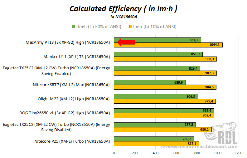

EFFICIENCY:
As I started in the previous review I published a few days ago, I am introducing a new feature to my reviews with an “analysis” of efficiency in lm·h.
Following the publication of the first “analysis”, and after some discussion exchange with several forum users, I decided to make some small modifications to the calculation.
(More details of how this calculation was made here.)
Basically what we do now is make two parallel calculations, one containing the runtime up to 50% and the other to 10%, so you get different values that will give us a more accurate approximation of efficiency, first reflecting the typical usable (50%), and another value with a more comprehensive measurement of driver efficiency (10%).
To calculate the cut in the formula ANSI value (higher measurement between 30 and 120 seconds after activation) has been used as reference to find the right cutting time.
Flashlights with flat regulation will score better in calculation to 50%, while those with a “direct drive” type regulation will do better in the calculation to 10%, but the combination of both values gives us a nice visual approximation to the efficiency grade of each flashlight.
