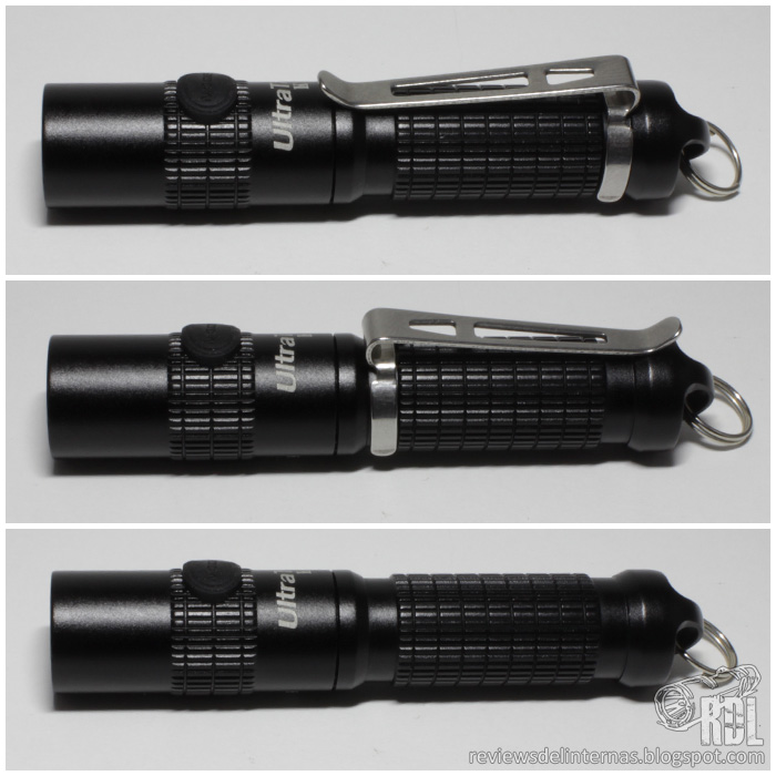

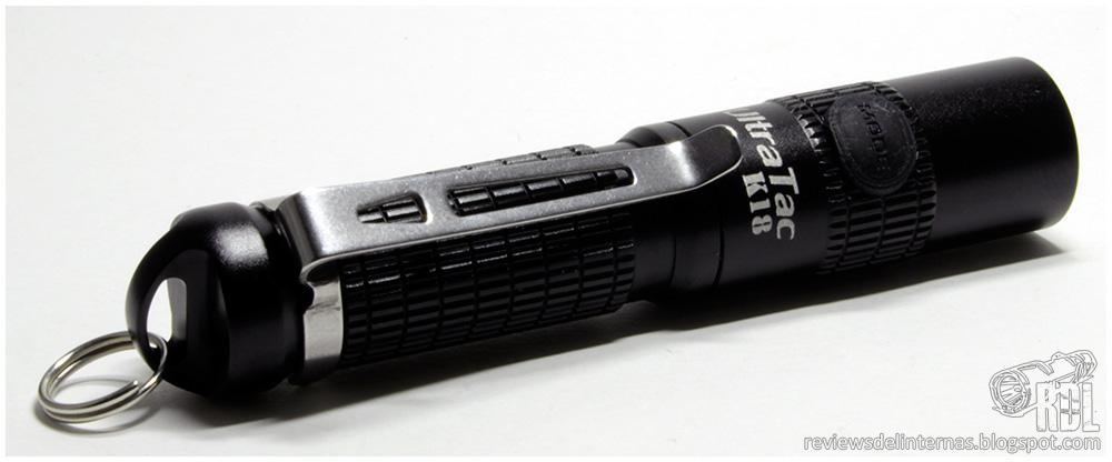

The Flashlight shows excellent finish. My unit is anodized in black, with a bit glossy touch, though fairly discreet. The main features of this Flashlight are quite compact finish with a rectangular knurling both in its central region and around the flashlight head.
Its measurements and weight are fairly contained, thanks to its side switch on the head is extremely easy and convenient to use.

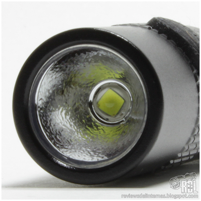

The optics of the small UltraTac K18 consists of an XP-G2 S2, with its small OP reflector. The LED emitter is reasonably well centered in my unit. The optical assembly is topped with a glass lens with AR treatment on a flat bezel. The optical finish is clean and well resolved.

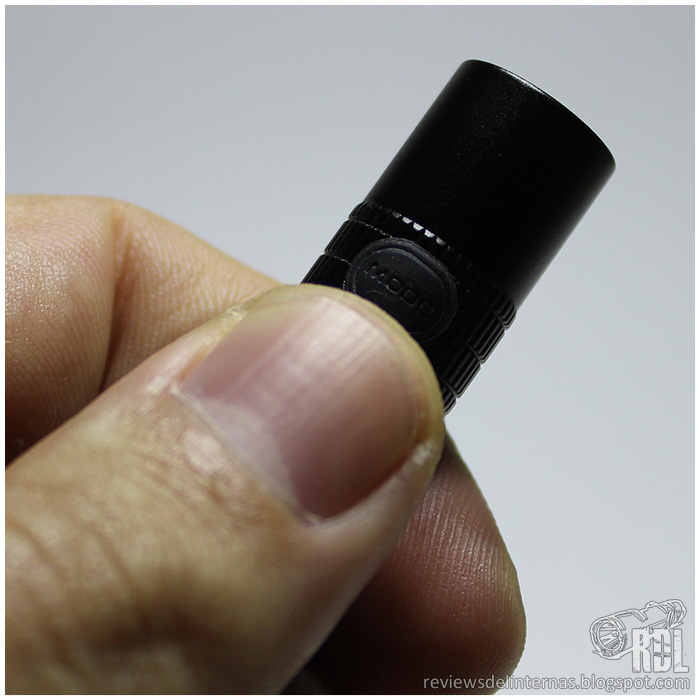

Right in the center of the head knurling track we have the greatest atraction of this small flashlight: a digital switch by which we will completely control all the user interface of this flashlight. This switch is covered by a silicone button, were we can read the word “MODE” extruded therein.
The switch protrudes just 0.9mm from the flashlight profile, but it’s simple and easy to locate by touch. This switch also helps keeping the flashlight from rolling if placed on a flat surface.

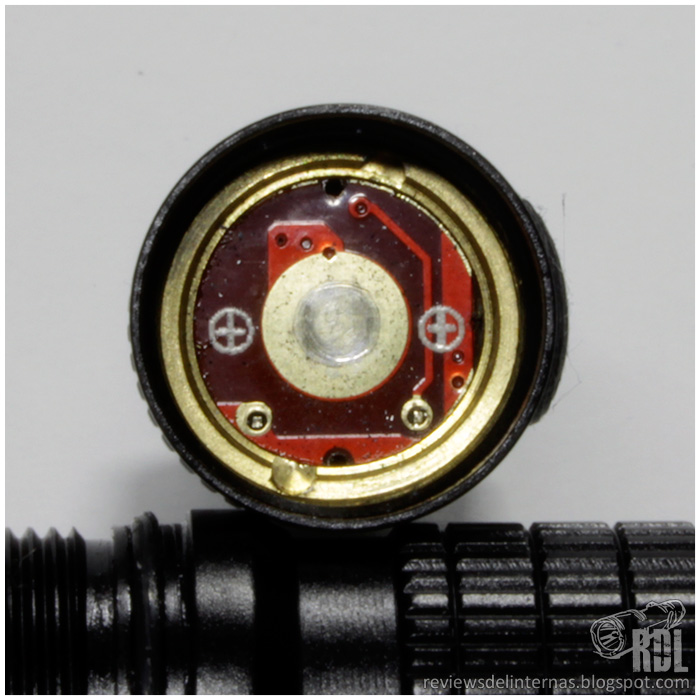

Inside we have direct view of the driver and its container, which seems to be machined from brass and seems to be easy to remove for possible upgrades or LED emitter replacements.

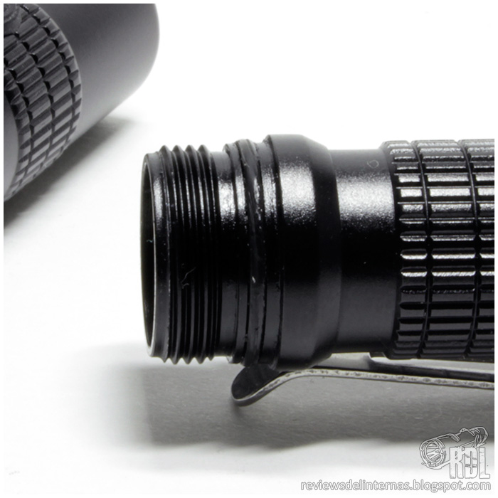

Flashlight threads are anodized and feature the classic triangular cut. They arrive correctly lubricated and clean. The play between the two threads is minimal, and one can feel perfectly as the o-ring contacts the inner walls of the flashlight when screwing both parts.
Inside the tube are a spring located at the bottom of the battery housing, which has a fairly high tension. The space for the battery, even having quite strong tension spring is generous and allows use protected 10440 batteries, which are usually always one or more millimeters longer than unprotected or usual AAA’s.

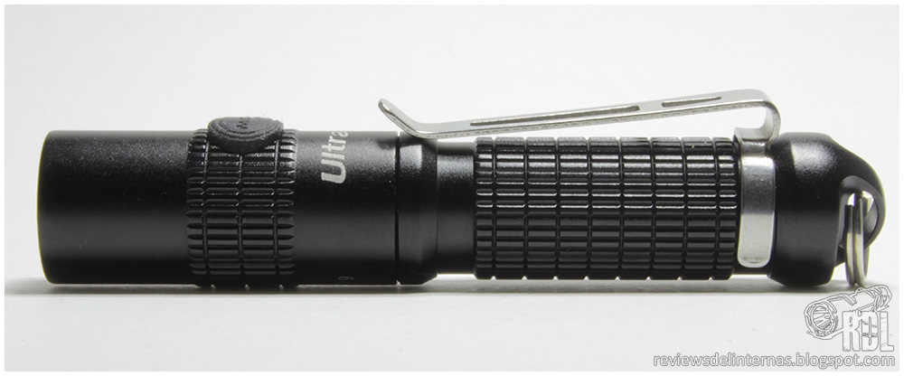

The flashlight body is almost completely covered by a rectangular knurling, and has two flat tracks to secure the pocket clip in two directions.
The tail of the flashlight features a large opening with a pre-installed split-ring. This anchor point has a rounded finish, so the torch cannot be placed tailstanding.

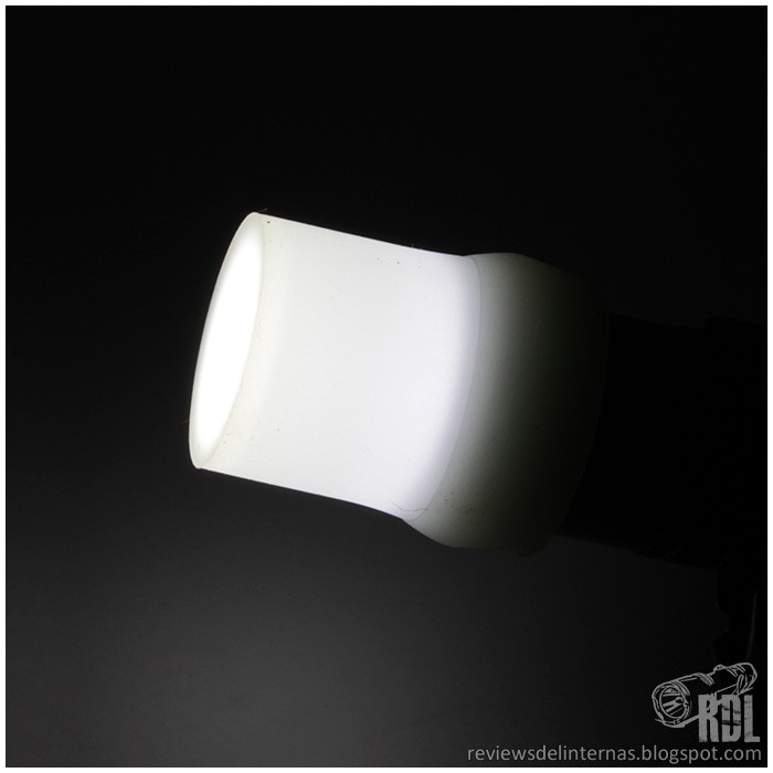

Finally, the manufacturer has included with this sample a small silicone diffuser, which is sold separately and which can turn the flashlight in a small portable lamp. The diffuser is very similar (or identical) to what we can be find in the Maratac AAA series, and is compatible with almost any AAA flashlight in the market.
A curious detail is that the diffuser is made of a material that glows in the dark, so that after turning off the flashlight the diffuser cap will continue glowing for several hours, making this extremely easy to locate in the dark.

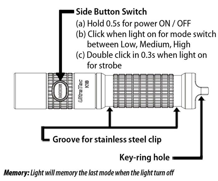

  • On and off: To turn on the flashlight, we must press the digital switch by half a second, and repeat the operation if we want to turn off the flashlight.
  • Changing Modes: With the flashlight on, just make a simple click on the digital switch to change modes, alternating between three intensities in ascending order: L-> M-> H
  • Memory: The K18 has mode memory function. This will remember the last used mode used prior to turn off, and will turn on in this mode in the next activation. The memory is retained even when the battery is removed off the flashlight.
  • Strobe Mode: As in other small AAA flashlights, strobe is a hidden mode, which can be accessed by a quick double click with the flashlight on. The frequency of the strobe is not too high, so it will be very useful as a locator/waring signaling.
  • Block-out: Having the switch quite exposed, fortunately we block out the flashlight when we don’t plan to use it to avoid unwanted involuntary activations. To do this, and thanks to its anodized threads, simply rotate a quarter turn of the head thread. Doing this will also stop the (always present in flashlights with a digital / electronic switch) parasitic consumption/standby current. After measuring the standby current necessary to maintain in “alive mode” the circuit of the flashlight, I have around 75uA (0.075mA) with an eneloop ( 1.4V) and around 18uA (0.018mA) with a 10440 ( 4.1V). Making a rough calculation, the K18 will completely drain by standby current a 800mAh AAA battery in 14 months, and a 320mAh 10440 in two years, of course regardless in both calculations of the self-discharge rate of the batteries themselves.
