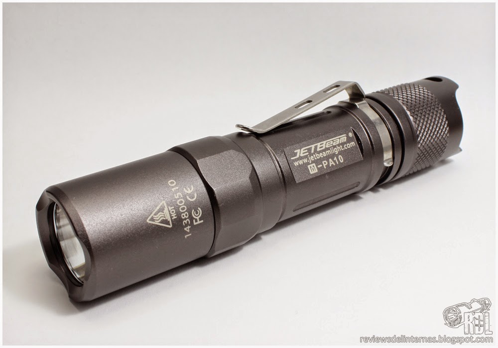

I don’t lie when I say that my first impression when removing the flashlight from the box, my thought was that it was an error and I was getting another model instead because due dimensions of the flashlight is easy to think that this is a compact 1× 18650 / 2x CR123A . But nope.
It is a robust oversized flashlight, wherein the wall thickness of the aluminum pieces that compose is imposing.
With a weight of 83 grams (excl. battery), 120mm long and 25mm in diameter, we are surely facing one of the largest AA flashlights on the market.
The exterior finish stands out for its dark gray anodized, very nice and uniform over all parts. Logos in white laser etched on different parts, all perfectly defined and readable by the high contrast to the background.
The head of the flashlight features a smooth bezel, slightly crenelated. In the neck there is a machining in which there are a number of flat spots that keep the flashlight from rolling when placed on a flat surface.

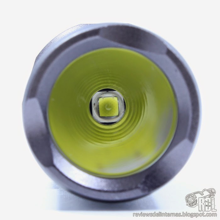

The optics of this M-PA10 is composed of a glass lens with AR treatment, a smooth reflector and a decently centered XM-L2. Inside we find the driver, with a mechanical against reverse polarity in the form of a ring surrounding the positive pole contact, which can cause some problems when using a 14500 with positive top not too sharpened.

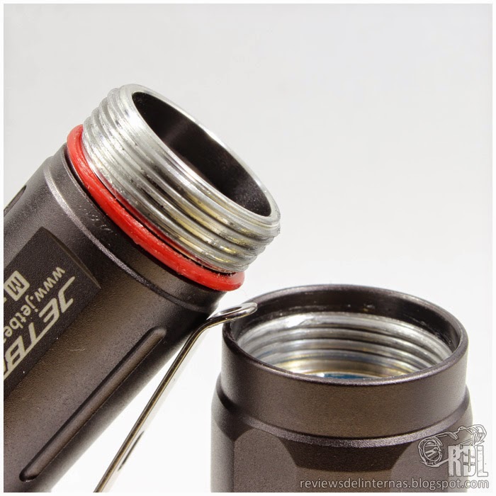

The threads have a trapezoidal cut, raw aluminum for the head and anodized in the tailcap. Come clean although no traces of grease.

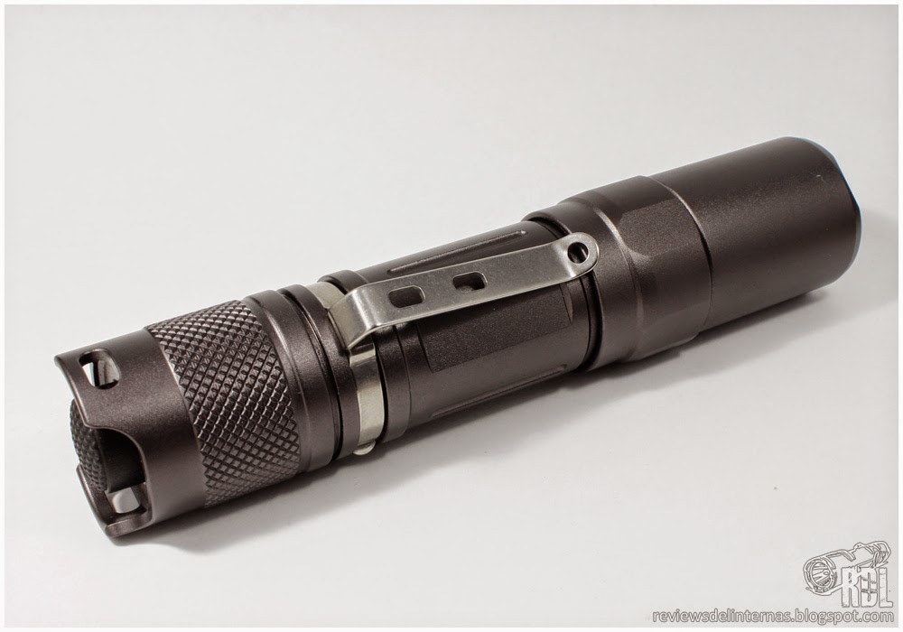

The tube features a clip which is clamped by pressure, and can be installed only in one direction. Clip tension is medium-low, and appears to clamp only 50% of the diameter of the track, so can easily “pop off”. The tube walls have 4mm aluminum, a considerable thickness.
The tailcap has the flashlight only knurled area, so it is easy (even with dry threads) unscrew the cap to replace the battery. The forward switch has a good feel, similar to the typical Nitecore forward switches, in which momentary activation is approximately 40% travel to click.
Two battlements surround the button, both perforated to provide an anchor point to the strap. Unfortunately, the button profile protrudes a few tenths of a millimeter on these battlements, so that the flashlight may be placed in tailstand, albeit unstable.

How it couldn’t be otherwise, the M-PA10 with its smooth but only ~20mm diameter reflector provides a medium-large size hotspot well defined and a more than acceptable spill for this type of multi-task flashlights.
The XM-L2 T6 tint is quite good, with complete absence of the typical greenish tones.
