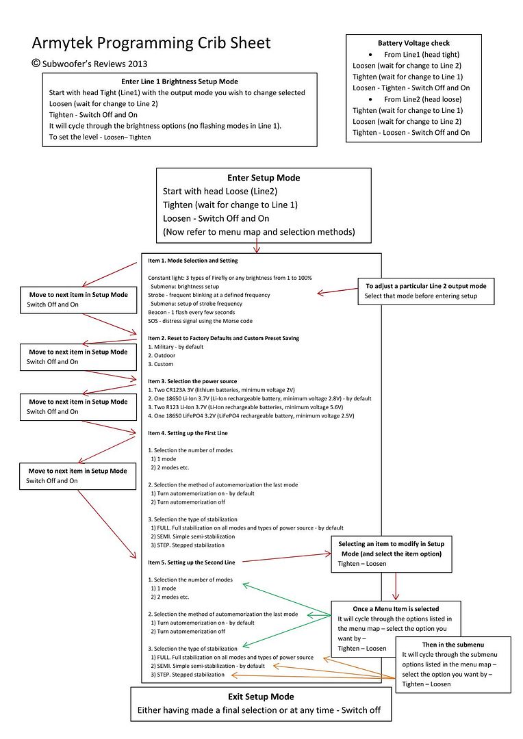

The Viking Pro v2.5's user interface features the fully programmable S-Tek driver and has two input methods to control this. The first is the forward-clicky tail switch, and the second is the head being tightened or loosened.
With the head tightened you are using what ArmyTek refer to as Line 1 modes.
With the head loose, you are using the Line 2 modes.
Each ‘Line’ can have multiple output modes. By default Line 1 has three constant output levels (equivalent to say Max, Medium and Low), and Line 2 has one flashing and one constant (strobe and brighter of three ‘firefly’ modes).
To change mode within the ‘Line’ you are using, either loosen then tighten (or tighten then loosen if using Line 2) quickly to move to the next output mode in that ‘Line’.
As supplied, you can just start to use the Viking Pro v2.5 like this, and you don’t HAVE to do any programming to customise it……..but you can, so why not.
This is where the Armytek give you something really is outstanding. No other manufacturer I know of gives the user so much control. It can be quite daunting at first when you take a look at the instructions. Here the Predator instructions are included:
(click to open the full size version of each page)
You are able to set the:
Number of output levels for each ‘Line’
What each and every output level (constant and firefly, strobe, SOS or beacon) is within the ‘Line’ (Line 1 only uses constant and firefly outputs)
Line memorisation on or off
The output stabilisation for each ‘Line’ (Full, Semi or Step)
The power source type (2xCR123 or 2xRCR123 or 1x 18650 Li-ion or 1x18650 LiFePO4)
Reset to factory defaults or use custom presets.
Also included is a battery voltage check feature which will indicate the battery voltage with a set of flashes.
Now that is outstanding!
As a quick note, there is one minor difference in the default settings on the Viking Pro v2.5 when compared to the Predator v2.0. This is simply the default power source. Armytek recognise that the higher capacity NNP 18650 cells which extend the usable voltage range down to 2.5V, so the 18650 LiFePO4 power source is now the default.
When first using the original Predator I found consulting the full double sided A3 sheet of instructions a bit overwhelming when trying to make a few changes, so I put together a single side of A4 as a set of condensed programming notes:
(click to open the full size version)
This summarises the three main tasks:
Setting up the Line 1 modes output levels.
Using the main Setup menu to configure the majority of options.
Displaying the battery voltage
You will still need to consult the ArmyTek instructions for the detail and planning what you want to set up, but hopefully this condensed guide will help you actually carry out the programming.
So with all of this choice, the biggest problem is deciding how you want to customise it!
