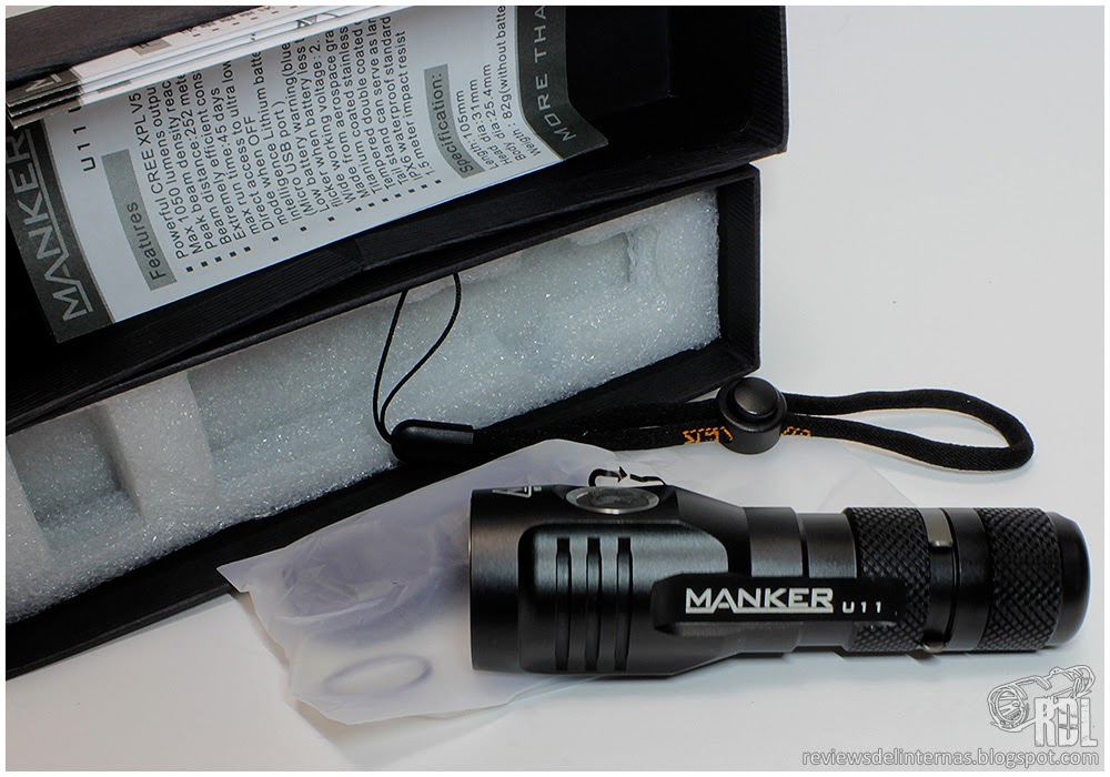

The product presentation is very similar to what we find in the production version of the T01, since the flashlight comes in a rather compact cardboard box with protective foam cut outs perfectly fitted to the dimensions of the flashlight and in which we find a user manual in two languages (English, Chinese), a set of replacement o-rings, a wrist strap and a USB charge cable.

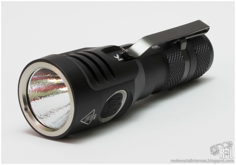

The machining of the U11 is quite similar to the T01. The entire machined aluminum of the flashlight is anodized in matte black. It is especially this lustrous anodized finish with its porosity free of any cheap-looking glossiness which gives a special touch to the lantern and blends perfectly with the accents in steel and the sandblast-finished clip.

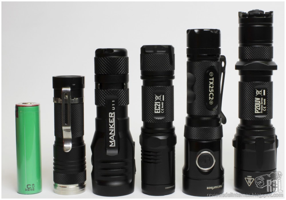

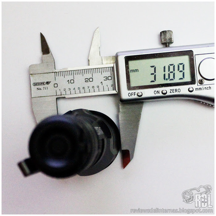

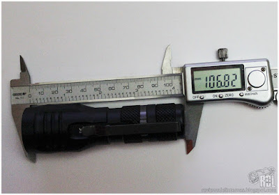

The dimensions of this flashlight are certainly compact. It looks similar to the MH20 by NiteCore or the TX25C2 by Eagletac in size, with dimensions and weight that make it more suitable for daily-use EDC, and that fits in most pockets.

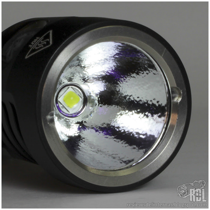

This time the Manker head optics don’t focus on far-reaching throw but feature an XP-L V5 (with dome) and OP reflector for a more balanced projection. An ultra-clear lens with AR treatment concludes the optics enclosed behind a smooth steel bezel.

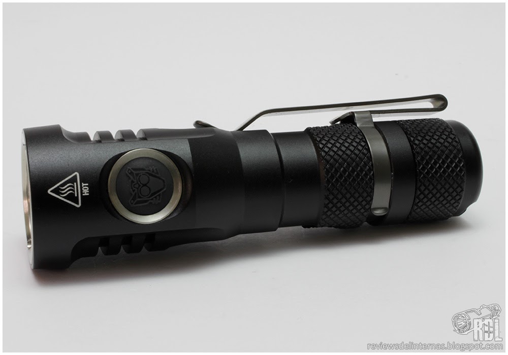

The head has a laterally placed switch, seemingly identical to the one seen on the T01, only now it has a backlight. On the opposite side of the switch, we have a microUSB port through which we can recharge our flashlight battery in place.
The head is surrounded with few massive cooling fins. As with the T01, the whole body of the flashlight is machined in one single piece of aluminum, with the tailcap being the only removable part.

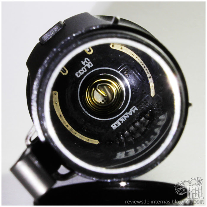

Inside the body we can make out the spring as the positive contact on the driver disc. The spring will make the flashlight run on any type of 18650 battery, be it button tops or flat tops.
The body of this compact flashlight has very elaborate machining, with many details and complicated forms, but the angles are all well finished with no sharp edges remaining. The ergonomics of the flashlight leaves, in my opinion, some room for improvement. Much of this evaluation is due to the unlikable pocket clip, which hinders comfortable holding of the torch. The clip itself is decent enough, very similar to what can be found on the T01, which the user anchors near the end of the flashlight body by snapping it with pressure into a machined groove. The finish of the clip is in the classic “bathed titanium”, with that dark metallic color and suppressed shininess. Being of the “low carry” type also doesn’t help with the comfort when unscrewing the tailcap of the flashlight.

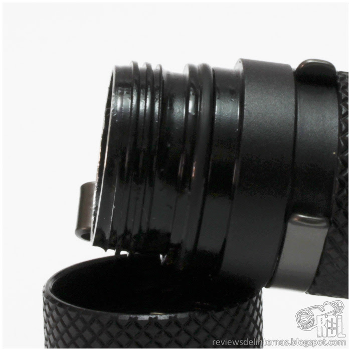

The threads are anodized and have a trapezoidal cut. They came clean and properly lubricated off the factory.

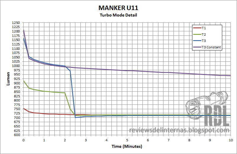

  • Constant turbo: As discussed in the next review section, the U11 has by default time-controlled stepdowns in its Turbo modes. Being aware of the controversy which such practice can provoke among users, Manker has provided a “constant” Turbo mode hidden in the series of blinky modes and programming options. This function will use the previously programmed Turbo mode (T1, T2, or T3) and try to maintain it “constant” throughout its runtime. This function causes an excessive flashlight temperature, so it should be used with caution.

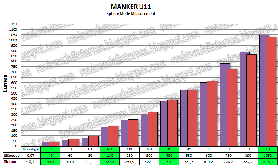

Measurements of the different modes in the integrating sphere show a very good agreement with the manufacturer’s specifications, with small variations in some ways. The intensity distribution is quite homogeneous, and the ability to program the intensity modes, except for the moonlight, gives us the ability to finely adjust the distribution of intensities to our tastes or needs.

The test result of runtime vs output in the integrating sphere is really good. All three Turbo levels have a stunningly high output. T3, the brightest of all, maintains its output above 1000LM for over one minute.
The ability to “override” the stepdown by the hidden “constant current” mode also allows us to see the difference between the two T3 power methods.
After the stepdown, the brightness always lands on the T1 level. For a better understanding of the overall performance, here a comparison against competitive lights.

Manker has equipped the U11 with a balanced combo of LED emitter and reflector, because its XP-L and OP reflector generate a very versatile mixed projection together.
The projection is very similar to what we would find with an XM-L2, a medium-sized hotspot with smoothed corona and uniform spill, without particular artifacts or rings as seen in the T01 with XP-L HI emitter and smooth reflector.
The XP-L V5 tint is pretty good, cool white with a very slightly tinted smoothed out corona surrounding the hotspot.
