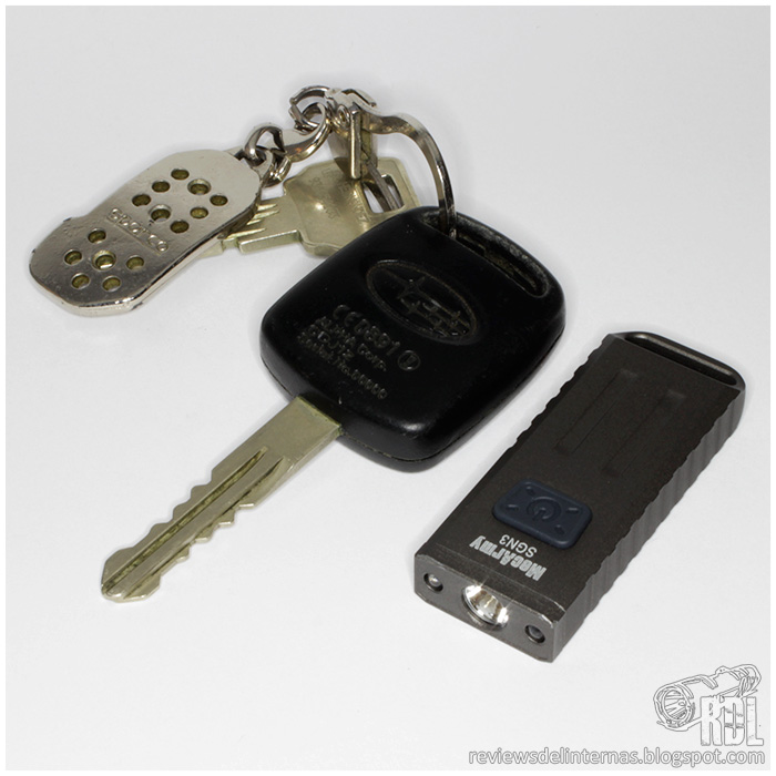

MecArmy is a new manufacturer in the scene, which seems to be focused on small EDC flashlights and care about exotic materials and minimalist designs. Among the innovations that this brand offers the SGN3 is undoubtedly one of the most original of its catalog as it is a flashlight concept not very common.
Product packaging is minimalistic, consisting of a small blister framed within a cardboard with full color prints, among which are some of the most important features of the product.

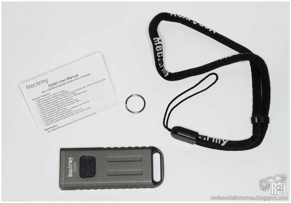

Inside the small blister, besides the SGN3 we find a quality, paracord adjustable wrist strap as well as a small user manual and a split-ring for the keychain.

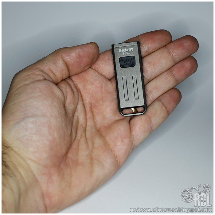

EXTERIOR FINISH:

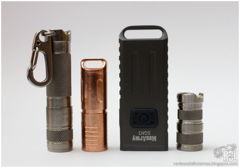

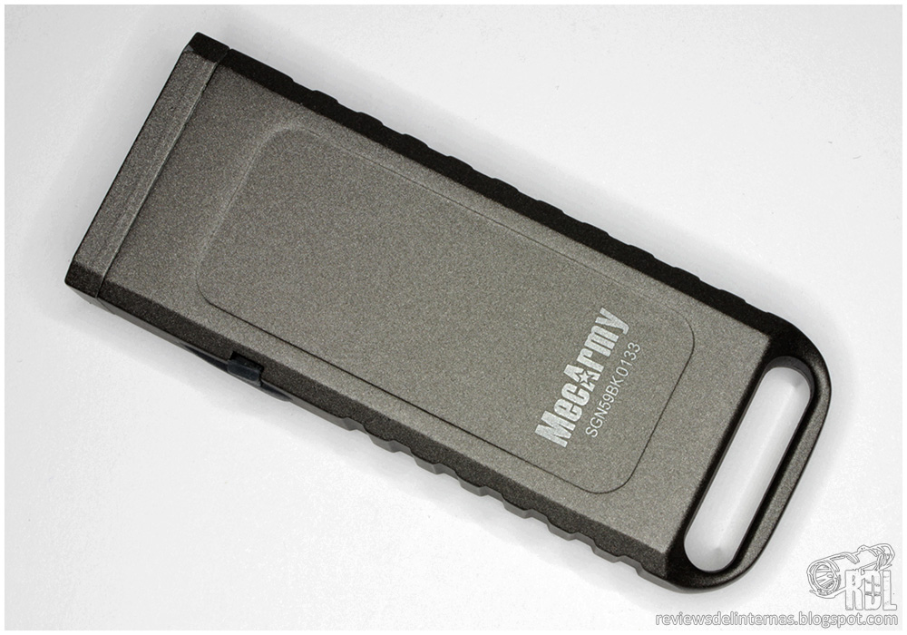

The design of this small keychain flashlight is certainly unique … it is a flashlight with its own battery, built-in inside and rechargeable via USB, so there is no need to replace it when it runs out, and by simply connecting it to the mains through Smartphone power adapter or similar it can be easily recharged. It is similar to the popular Nitecore Tube concept, but built with durable materials and with much higher performance and functionality.

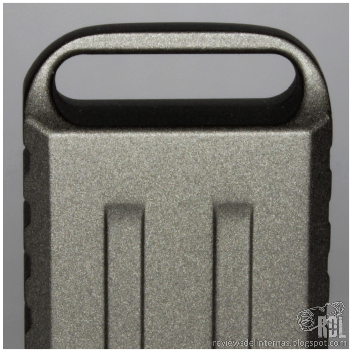

The first interesting detail is the way in which MecArmy produced this piece, as instead of CNC lathe machined aluminum they used diecast/metal injection, using a mold to which is added the melt liquid metal, in this case zinc (according manufacturer), and it is allowed to solidify to the desired shape. This process is much more expensive than traditional CNC turning, but also has some advantages such as design freedom when it is not a typical cylindrical shaped piece.
The body, offered in various colors like black, gray, olive green or sand, has nicely defined laser engravings, with the finish of the metalwork is great, with all edges well rounded and smooth exterior finish. Color, rather than the typical anodizing, has been applied by a layer of ceramic paint which is then baked to make it more durable and robust.
The optics of this SGN3 are quite peculiar, as we have in the middle a CREE XP-G2 with its own smooth reflector and glass lens, similar in size to that would be in any AAA flashlight, and at each of the sides there are small 3mm LED, one red and the other UV.

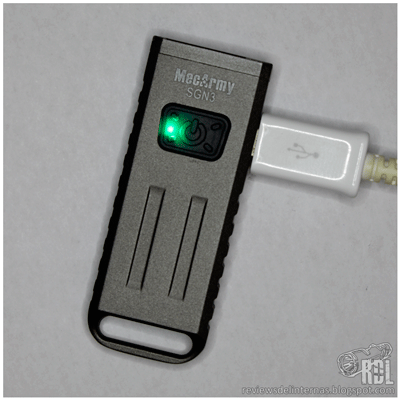

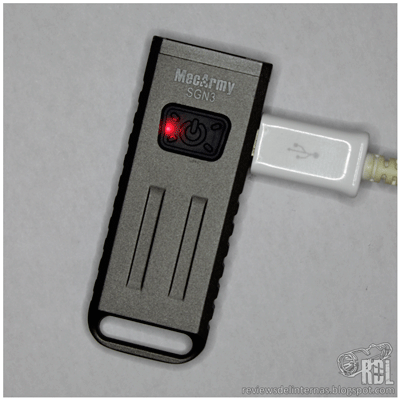

We have a silicone button coating the digital switch that hides beneath its surface two colored LEDs are used as recharging status indicators. The touch feel of the switch is good, and thanks to the generous surface it occupies and its slight protruding it is extremely easy to locate by touch.

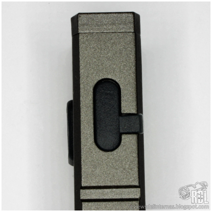

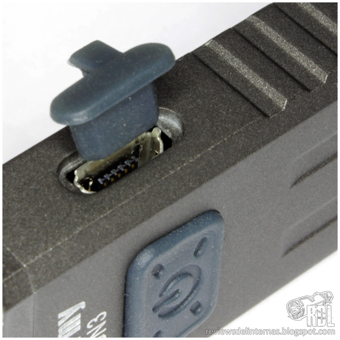

On one side we have the charging port, microUSB shaped, protected by a rubber cover having a small flange-shaped handle, which greatly facilitates the action of removing the coating using a fingernail.
The tail of the flashlight is dominated by a huge anchorage area, allowing us to pass through it any split-ring, cord or carabiner to attach the light everywhere. The rounded ring shape prevents this SGN3 from tailstanding.
As mentioned before, the design and concept of this MecArmy closely resembles that of the popular Nitecore Tube, although in my opinion the materials and functions used in the SGN3 make it far superior to the cheap Nitecore proposal.

  • Recharge: The integrated battery of 280mAh capacity (according to manufacturer) is easily recharged using any Smartphone or similar adapter, with microUSB jack. A full charge takes approximately an hour and a half. The signal LEDs located under the cover of the digital switch will change from red (charging in progress) to green (fully charged).

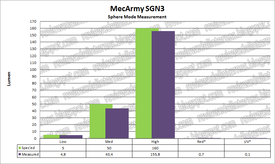

(All measurements are taken following the procedure ANSI NEMA FL1, taking as value the highest reading of between 30 and 120 seconds after activation. More details here.)
The distribution of modes is fairly balanced, and considering that the Med mode is the default, I find it a nice intensity according to a common daily use of a keychain flashlight. White light modes, except High, are achieved by PWM, although high frequency because it is difficult to see at naked eye.
On the other hand, I measured the visible light emitted both by the red and UV LEDs, thus obtaining approximate values, although I must point out once again that the sphere concept with which I work disregarded the color at the time of its construction and calibration, and those numbers do not have any interest beyond the merely speculative.

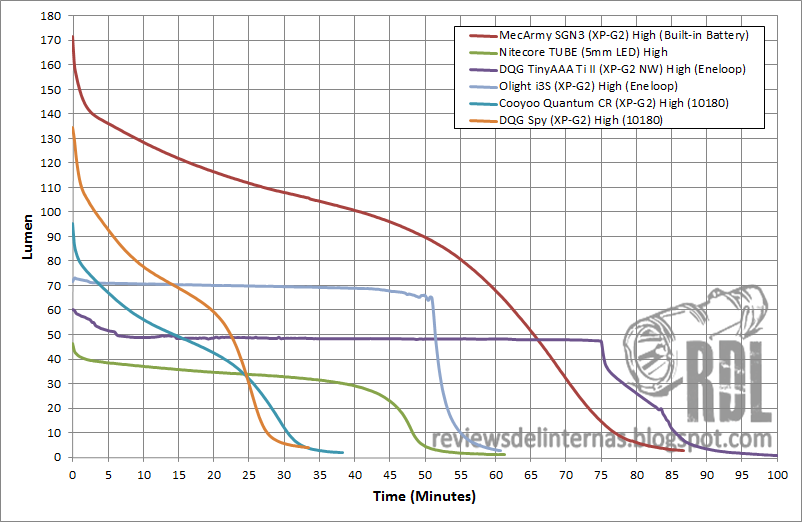

Instead of betting on a typical Li-Ion performance in keychain light (AKA, using a 10440 in a AAA flashlight) MecArmy has opted for a neutral performance, halfway between the typical curve of a NiMH AAA and the maximum high output from a 10440 powered flashlight.
The result is a line such as “unregulated” featuring a relatively high output when compared with a AAA NiMH, and extended runtime when compared with 10440.
Interestingly, flashlight, instead of an abrupt downturn or off when the battery is about to run out, makes a progressive decline in the output, giving us a clear signal that it’s time to recharge its integrated battery.

Ещё мне непонятно, как его открыть если понадобится поменять аккумулятор или ещё какой-то ремонт.
