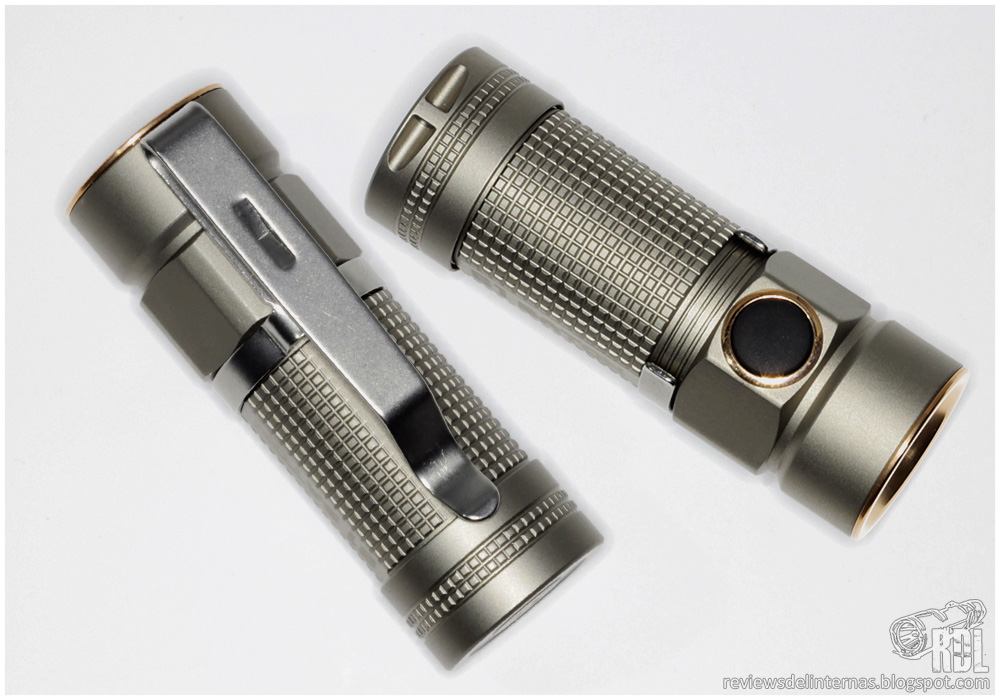

External machining of S1 Baton Ti is identical to anodized aluminum base version, but with the obvious difference in the material used.
The sandblasted titanium has a porous touch, and although it is more likely to be marked if struck or rubs, completely avoids the flashlight full of fingerprints left after being used.
It is a compact flashlight, with reduced dimensions and weight, which make it an excellent candidate for an everyday carry flashlight as it lives comfortably in any pockets.

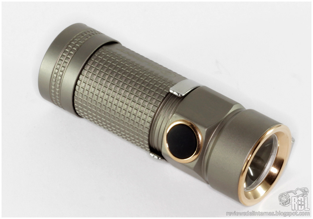

Instead of blue accents as in the base version has this S1 Ti version has the bezel and the frame surrounding the switch in a copper-gold color.
The optics consists of a TIR type lens very curious, since instead of having a smooth outer surface has a slight relief that follows the shape of the collimator.
The emitter is completely hidden behind the central part of the lens, which appears to have a dull finish and prevents a direct view of the central zone.
The switch is coated with a silicone button, and protrudes slightly on the profile of the flashlight, but his touch is rather hard.
The small button on the side is located in one of the planes of a zone exagonada flashlight body, which acts as an anti-roll mechanism.

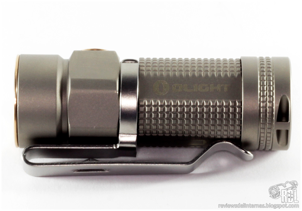

We have a steel pocket clip attached in the neck, which has a good tension.
The engravings found in the body of the flashlight are clearly defined, but are quite discrete thanks to the low contrast.
The flashlight body is dominated by a very nice rectangular knurling, with three flat areas, all of which laser engravings, logo, model and an indication on the polarity for the battery, the latter being hidden by the pocket clip default position.

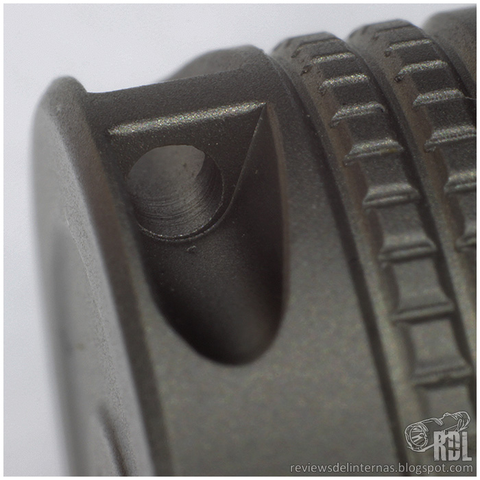

Outwardly the tailcap has knurling small strip that matches the one found in the body. At its edge there is a small hole allowing us to attach the strap wristband or any hitch. The base of the plug is completely flat, so we can place the flashlight in tailstand, which added to the small diffuser included with flashlight offers excellent functionality. The diffuser cone has an interesting peculiarity is that is made of luminescent material, so that after the cone off the torch will maintain a slight glow that can be very helpful to locate it out in complete darkness.
Finally, the tailcap has an engraving consisting of Ti acronyms, and a serial number that identifies our unity. Taking advantage of my recent acquisition of a ring flash for my camera “low cost” equipment, I’ll leave you with some interesting macro photos of this special flashlight.
