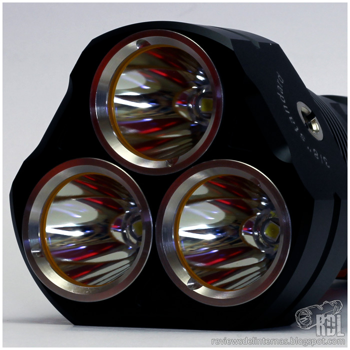

The lantern has a triple optics, which have three completely independent reflectors, each with an XP-L under a smooth reflector and AR coated lenses, topped by stainless steel bezels.
The centering of the LED emitters can be improved, but given the nature of this flashlight I think this detail will go unnoticed.
