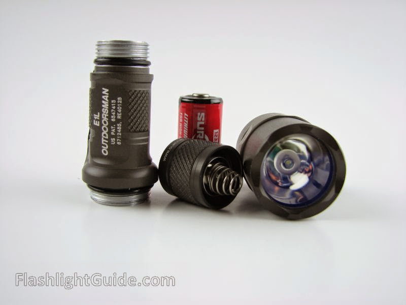

The SureFire E1L-A Outdoorsman is the latest variant of the SureFire E1L series of flashlights. Designed to provide extended runtime, the dual-output E1L-A is powered by one 123A lithium battery and is rated to provide 5 lumens for 41 hours in low mode and 90 lumens for 6 hours in high mode. As with previous versions of the E1L, the new Outdoorsman utilizes a Total Internal Reflection (TIR) lens to focus output and is controlled by a pushbutton tailcap.
The E1L-A always comes on in low mode first, with high mode selected by an additional press or click of the tailcap button.
The E1L-A features aerospace aluminum construction and uses the same body and tailcap design as previous versions. The most notable differences with the new version is the addition of SureFire's 2-way pocket clip and the completely redesigned KE1 head. The E1L-A can be disassembled into its major component parts which are completely interchangeable with other SureFire E-series lights.
The 2-way clip allows the light to be carried in either bezel up or bezel down positions and can be used to attach the E1L-A to the brim of a cap. With its small size, the E1L-A is extremely comfortable to carry when clipped in a pants pocket.
