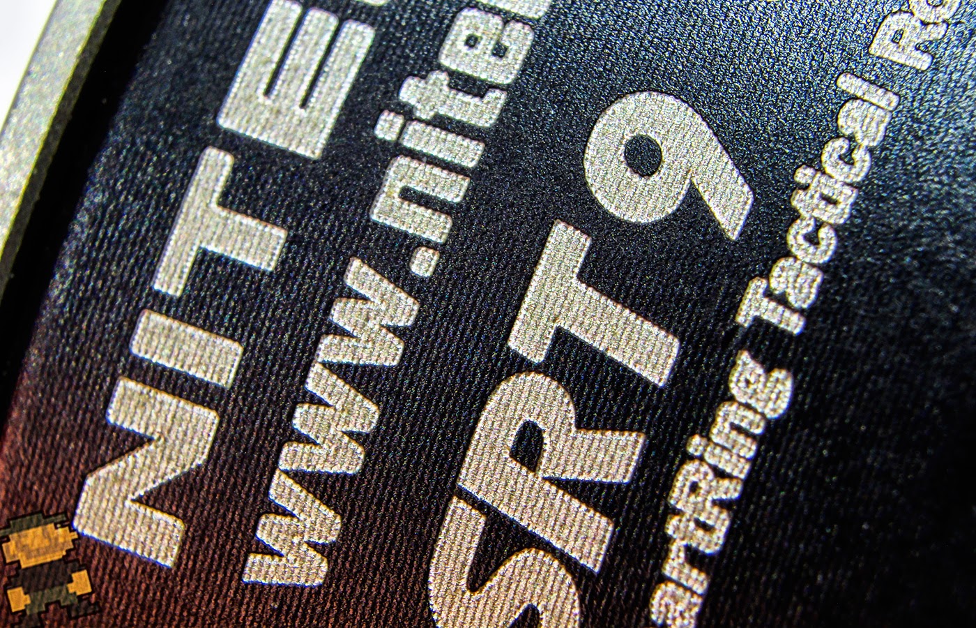

The box follows the line of the rest of the products of the brand, and shows printed in full color indications and characteristics on the flashlight.
Inside the box we find the flashlight, a textile holster, wrist strap, spare tailcap gasket and user manual (now also in Spanish, among many other languages). Inside the flashlight we will find an anti-humidity gel sachet.
