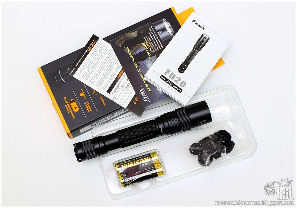

The presentation of the product is excellent, as is usual in Fenix. Inside a printed in full color with specifications and various details about the product cardboard box we find a plastic tray containing the flashlight and its accessories.
As well as the flashlight, we will find a lanyard, the typical o-ring and silicone push-button replacement, a pair of alkaline AA batteries, warranty card, user manual and a basic textile flashlight cover.
Although simple, the holster works perfectly with its function and it is always appreciated that the big names do not ignore or forgot about these details.
