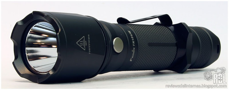

The exterior appearance of the TK15UE is already well known. This is a classic tactical-looking flashlight, with a simple but effective machining, with classic lines and this time with a special anodized quite elegant. Unfortunately the camera has been unable to pick up the exact tone of the anodizing.
It has intermediate dimensions, being smaller and shorter than the TK22, but slightly longer than the TK12 / TK09. Its dimensions are 143 millimeters in length and a maximum diameter of 34mm in optics, weighing 140g (without battery).
The tone of the anodized is very similar to the bluish gray that some classic lights used years ago, although depending on the tone of the light with which we illuminate that gray it turns slightly to a military green.
The flashlight is built entirely in anodized aluminum, including in this case also the bezel, which in the base version and also in the black version Ultimate Edition is done in stainless steel.
The optics of the TK15UE are composed of a slightly crenellated aluminum bezel, an ultra-clear glass lens with AR treatment, an immaculate smooth reflector, and in the background a CREE XP-L HI emitter perfectly in the center in a white plastic centering mechanism.
On the side of the head we find a digital switch, covered by a steel button. This button is smooth and can be somewhat difficult to locate to the touch, especially if we use gloves.
The inner contacts for the battery are more than worked, with spring at both ends to cushion any jolts produced by a firearm if we used the TK15UE installed in its rail.
The threads have the typical trapezoidal cut that we find in the great majority of Fenix lights. They come clean and lightly lubricated. The tactical ring, made of anodized aluminum of the same color as the rest of the lantern and also acts as an anti-roll mechanism, can be removed by unscrewing. The design of the clip is the same that can be found in other Fenix lights, with a very robust clip grip.
The tailcap design, where the flashlight houses its second switch, in this case a mechanical type of forward (also known as tactical), prioritizes a quick access to the switch in front of the possibility of putting the flashlight on tailstanding.

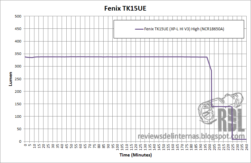

Apparently, the latest models of Fenix incorporate a new feature that comes to supplant the previous trend of time controlled stepdown…
Instead, Fenix now incorporates for its maximum performance mode a thermal management system that will try to maintain maximum output as long as the temperature allows it. In the test, assisted as usual by a small fan, the flashlight has been able to maintain itself without doing the stepdown for almost 90 minutes, at which time presumably the voltage was insufficient and the flashlight went straight to the Medium mode, and then down again to the Low mode and remain on after two hours of uninterrupted use.
The high mode shows a linear performance, as we were accustomed to date, with a battery power management identical to the one we have seen in the last two stepdowns of Turbo mode.
Compared with other similar flashlights, the TK15UE is the only one I have tested that does not make a drastic drop after a few minutes of uninterrupted use, and even equals or even surpasses other alternatives thanks to a better efficiency, among other things, the use of a much more modern LED emitter.
