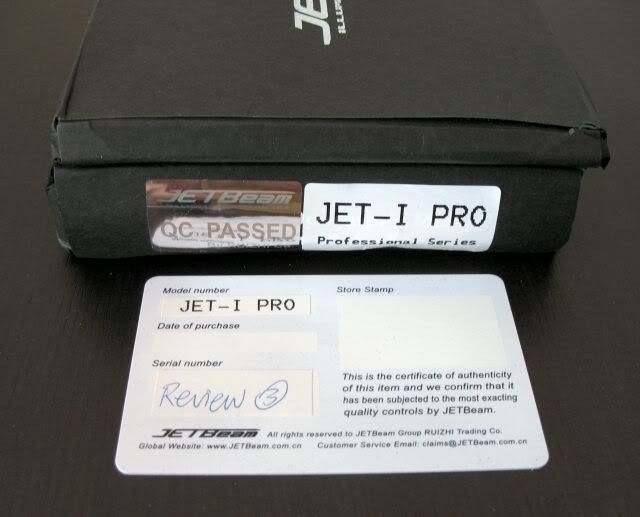

My review sample came in a thin cardboard box with JetBeam logos, and some light foam insulation inside (frankly, I’m surprised the box survived transport as well as it did, as it came packaged inside a regular bubble envelope).
Inside, you’ll see it comes with warranty card, manual, wrist lanyard, and spare parts (o-rings, tailcap cover) – and of course, the light. Quality of the lanyard seems pretty good. You’ll note my sample is identified as “Review 3”.

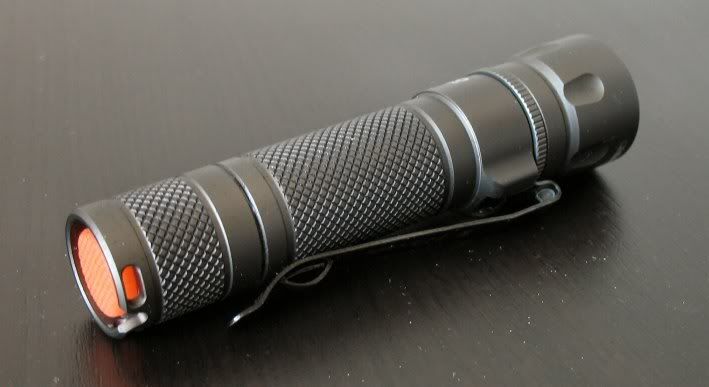

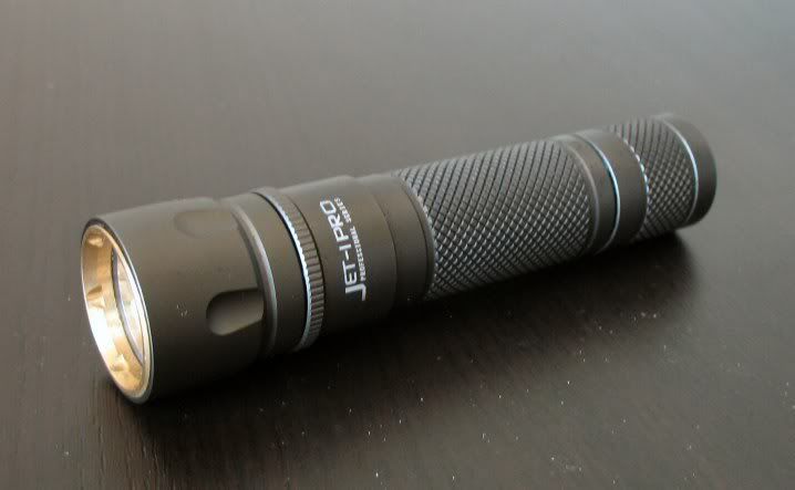

As you can see, exterior styling is very nice. Light comes in a dark grey HA (type III) finish, similar to the JB C-LE. The metal clip is detachable (with some force). Knurling is not overly aggressive, but it is slightly more raised than most Chinese-made lights.

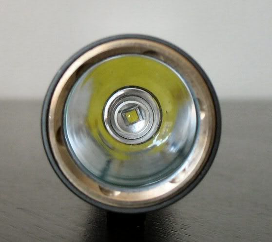

As you can see from the business end shot, the Jet-I PRO uses the “silver” version of the new Cree R2 emitter (i.e. the area outside central die is silver in colour, instead of the standard Cree yellow). My understanding is that there are no output differences between the silver and yellow versions, and these simply reflect different manufacturing plants. However, there may be some tint issues (see my Build Quality section further down for a discussion).

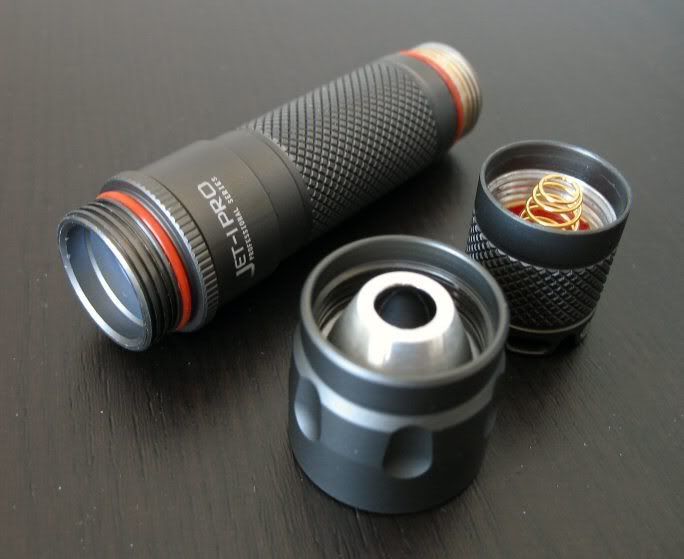

The light engine can easily be unscrewed from both the body and the head/reflector, opening up the possibility of easy upgrades (should JB provide upgrade modules). Like my JB MkIIX, there is a spring at the base of the light engine (i.e. at the positive battery terminal) so 14500s should not be a problem. Tailcap and switch are similar to MkIIX and C-LE v2. Note the presence of square screw threads, a favourite with machinists (and rare on flashlights). Note the brassy/gold-coloured coating on the inside battery tube and contact threads (apparently for some sort of anti-oxidizing effect, similar to the EDGETAC NiteCore DI).

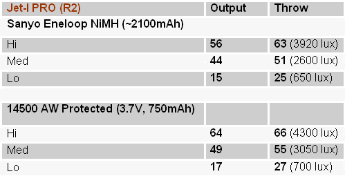

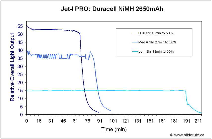

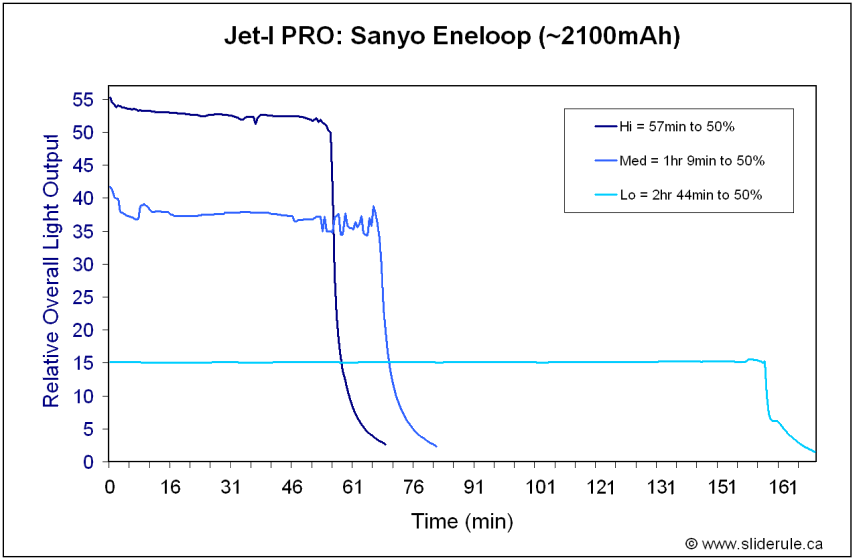

Testing Method: All my output numbers are relative for my home-made light box setup, a la Quickbeam's FR.com method. My relative overall output numbers are typically similar to his, although generally a little lower. You can directly compare all my review graphs - i.e. an output value of "10" in one graph is the same as "10" in another. Throw values are the square-root of lux measurements taken at 1m using a light meter.

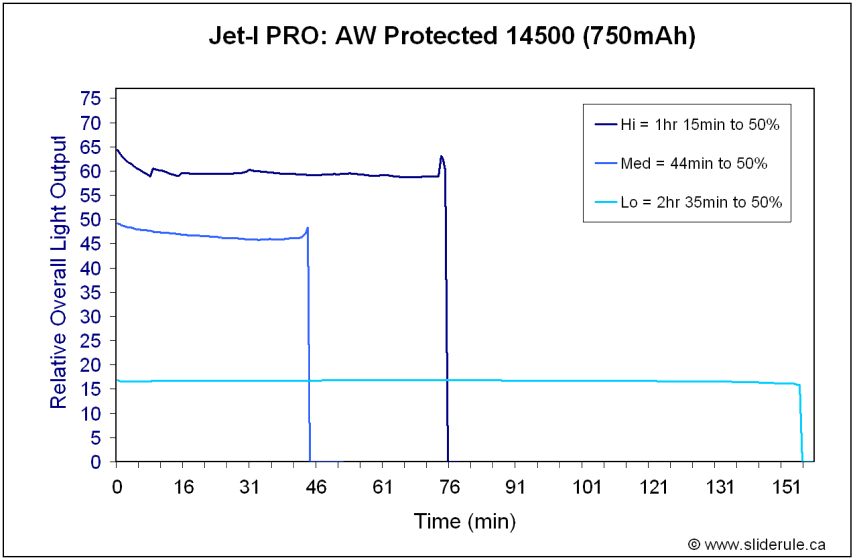

Runtimes:

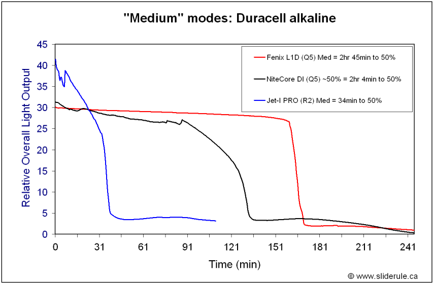

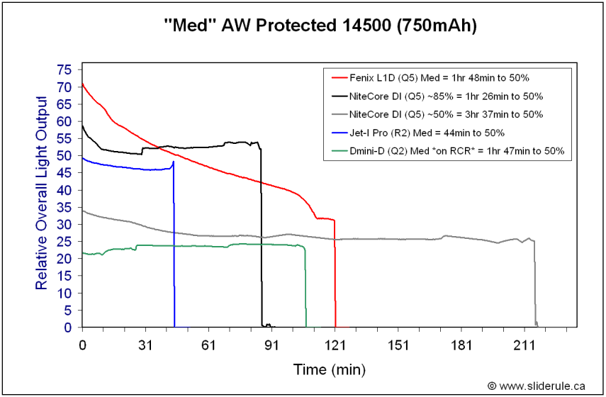

Yes, you are reading the graph above correctly - Med mode has both lower output and lower runtime than Hi on 14500. JetBeam is aware of the issue, and plans to fix the circuit for the next batch of lights produced.
Although I didn't show it in the table, 2650mAh NiMH and alkaline have very similar initial output and throw as the Sanyo Eneloops.

  • I’ve very impressed with the maximum throw of this 1AA light, on all battery types. Surprisingly good, given the size of the reflector.
  • Maximum output on alkalkine and NiMH (both high-capacity and low self-discharge) is excellent, comparable to the EDGETAC NiteCore DI (which was first 1AA light to really push the envelope for output on AA).
  • Also like the NiteCore DI, output on 14500 on Hi is good - but not that much brighter than NiMH. This is also deliberate on JetBeam’s part, in order to maintain good regulation and thermal management. But this means that some of the older lights that run direct-drive on 14500 (like the Fenix L1D and JetBeam’s original MkIIX) will be brighter initially on 14500 (but with lower runtimes, of course).
  • Efficiency of the Med/Lo modes is not very good on the Jet-I PRO. In fact, there is some problem with 14500: you get less output and less runtime on Med.
    EDIT: JetBeam has informed me that they plan to fix this circuit issue for the next batch of lights.

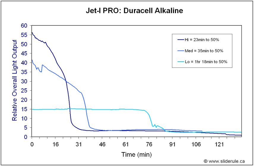

  • Alkaline runtimes are disappointing in all modes. I don’t serious expect that many would be running this light on alkalines routinely, but other high-end lights seem to do a much better job (scroll down for a comparison)

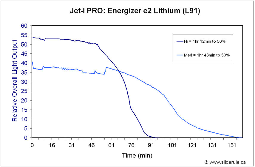

  • Runtimes on Energizer e2 lithiums (L91) also seem unusually low

Build, Machining and Anodizing
  • Build quality is top-notch, as good or better than other JetBeam lights I’ve owned (which were all quite decent).
  • Machining is very good throughout, although the raised portions around the tailcap switch are a bit rough (i.e. like the C-LE and MkII series lights).
  • Light features square screw threads, which should help reduce risk of cross-threading.
  • Diamond pattern knurling is slightly more aggressive than most Chinese-made lights (although still nowhere near Surefire “rip a hole in your pant’s pocket lining” type of knurling ).
  • Brass (?) ring in the head of the light has some crenellated divits in it, and looks fairly attractive in my view. Doesn’t seem to have any actual function beyond decoration.
  • Metal clip is removable, but you have to use a fair amount of force (and may risk scratching the anodizing).
  • Anodizing is perfect on my sample, and is a very nice slate gray natural finish (HA-III).
  • Lettering is very and crisp, no blemishes on my sample.
  • Gold-plated battery springs are present on both the light engine and tailcap, so all batteries should make good contact. But the extra tension makes it so that the screwing on the tailcap is a bit “stiff” with the battery installed (common feature on all my JetBeam lights).
  • Some protected 14500 may not fit due to extra battery length and tight fit with the springs (my AW 14500 fit ok, but are rather tight).
  • Switch is a standard reverse clicky, slightly stiff, with a standard traverse. Switch retaining ring is made of plastic - not metal - so be careful you don't over-tighten it. Also, I've noticed part of the spring getting caught under the retaining ring a couple of times while changing batteries (needs a gentle tap to dislodge and spring back up fully straight).
  • The tailcap threads are unfortunately NOT anodized, so tail-cap lockout is not possible.

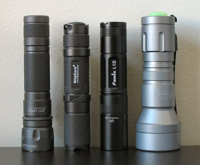

For this part of the review, I am going to compare the JB Jet-I PRO (R2) to the EDGETAC NiteCore DI (Q5), Fenix L1D (Q5), and LumaPower Dmini-D (Q2).

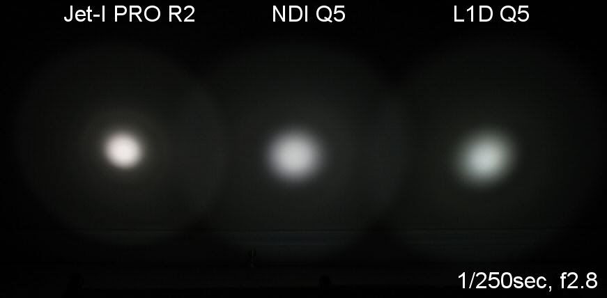

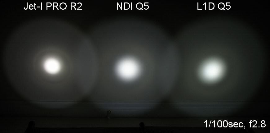

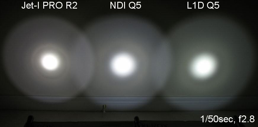

Comparison of beamshots. From left to right, JB Jet-I PRO, EDGETAC NiteCore DI, Fenix L1D, all on Hi on 2650mAh Duracell NiMH.
The Jet-I PRO has a tighter hotspot than the other 1AA lights, thanks to the bigger reflector. It is also a bit “ringier” due to its smooth reflector (for maximum throw). Tint on Hi is a premium white, slightly warm (but see discussion below for low modes).

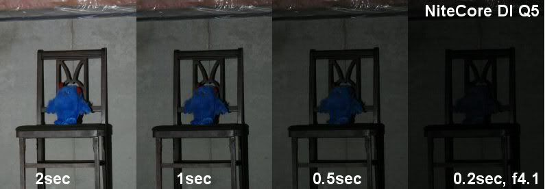

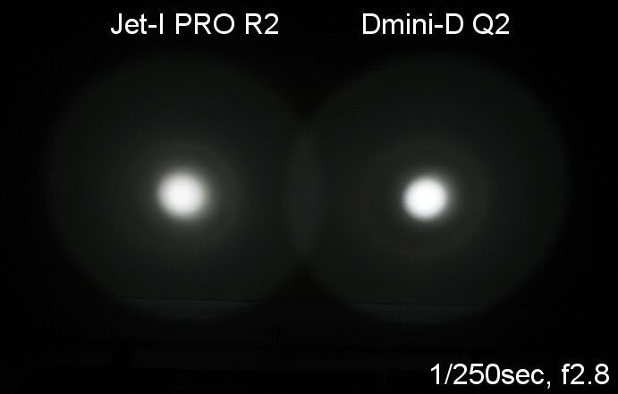

Frankly, I think a better light to compare to is the CR123A-based LumaPower Dmini. Below are comparison shots to my Q2 version of the Dmini-D, both lights on AW protected Li-ion rechargeables (14500 for Jet-I PRO, RCR for Dmini-D)
As you can see, beam profile is remarkably similar to the Dmini.
How well does it really throw in comparison? I’ll give you some lux @1m numbers in a minute, but I don’t think they tell the whole story. A picture is worth a thousand words ... here are some multiple-exposure beamshots of a "gremlin" at 50 feet in my basement.
While not quite as bright as the Dmini-D Q2, you can see it does a much better job at 50 feet than the more general-purpose NiteCore DI does.

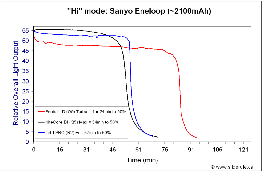

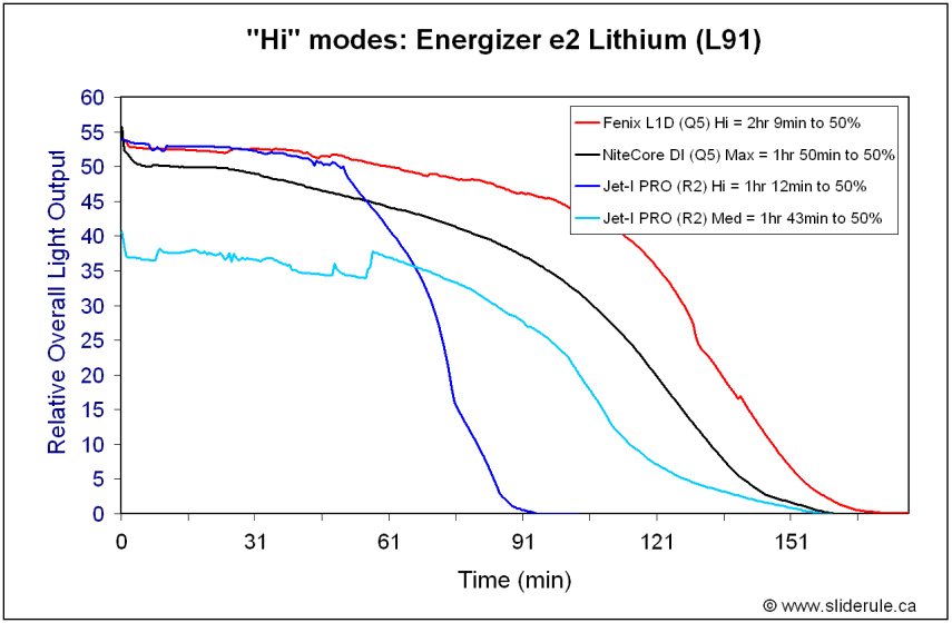

Runtimes:
Output/runtime observations:
  • Maximum output on the Jet-I PRO is comparable to the NiteCore DI on all battery types. Runtimes are also comparable, except on alkaline where the Jet-I PRO underperforms somewhat.
  • Med and Lo output levels of the Jet-I PRO are slightly higher than Fenix L1D or Dmini, but not by much. Runtime is typically inferior to the other 1AA lights, however.
  • Regulation is very good on all rechargeable battery types. Like the NiteCore DI, it’s clear that this light was designed to excel on rechargeables (NiMH and Li-ion).
  • Runtime on alkaline is very poor at all levels, compared to other 1AA lights (especially on Lo).
  • Runtime on Energizer e2 lithiums is also lower than other lights.

  • Output and runtime on 14500 is very good, with output somewhat brighter than regular batteries (although not the brightest I’ve seen – on 14500, Fenix and JetBeam models are brighter, but shorter lasting).
  • Regulated output on rechargeable battery types in all output modes is very good (e.g. unlike Fenix or earlier JetBeam lights on 14500, where you loose low modes)
  • Efficiency on Med-Lo mode is significantly lower than the competition. Further, there’s an issue with 14500 on Med having both lower output and lower runtime than Hi - this needs to be fixed.
    EDIT: JetBeam has informed me that they plan to fix the Med-14500 issue for the next batch of lights.
