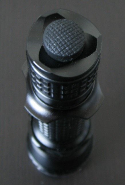

Like the M20, all components seem sturdy and well built. Everything fits together well, with double o-rings and smooth screws threads at all openings (tailcap threads are anodized, allowing tailcap lockout). Tailcap spring is not exposed, but encased within an assembly with a button top. Note that the tailcap is interchangeable with my older M20 – nice to see they have kept the specs consistent for over a year! .
There is a spring mounted on the positive contact board in the head, so recoil should not be a problem. And newer flat-top higher capacity 18650s should work fine.
The bore width is good, so all batteries should fit. A battery magazine is supplied to help prevent rattle with 2xCR123A. Note that the magazine is optional, but if nothing else, it provides a good storage means for backup cells.
Machining and anodizing of the light are top-notch on my sample. The raised checkered portions help with grip, though not as "grippy" as aggressive knurling. The attached anodized clip and grip ring also help enhance grip, and both are removable. Included in the kit is a smooth replacement cover for the grip ring (i.e. the grip ring screw threads would be exposed otherwise). Overall, I would have to say hand feel remains excellent in all configurations.
The light can't tailstand - but that's not uncommon for "tactical" lights, since tailstanding rings tend to obstruct easy access to the clicky switch. Light comes with a forward tactical clicky with good tactile feel (momentary on, click for lock-on).
