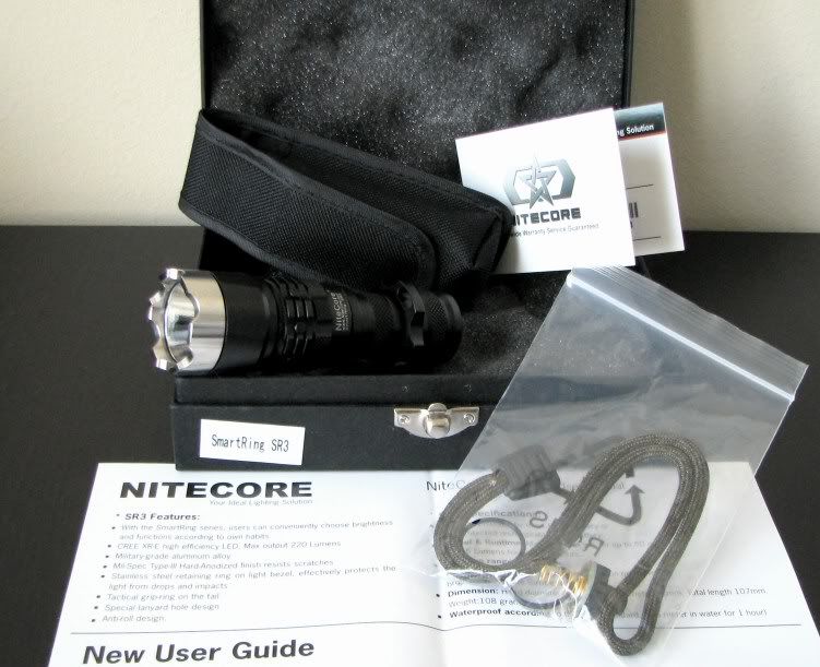

The SR3 comes in the high-end Nitecore light packaging, featuring a hard cardboard presentation box with closing clasp and textured foam. The light comes with a carrying pouch, wrist-strap, manual, warranty card, spare o-rings, and spare tail-cap switch.

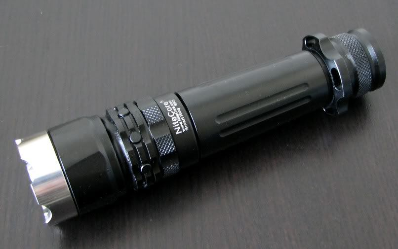

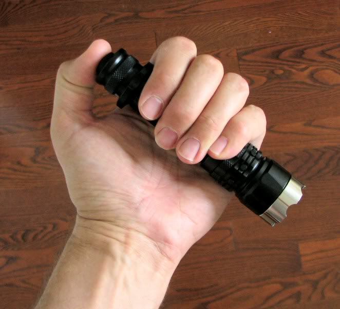

1xCR123/RCR body: Weight 108.1g, Length 107.6mm x Width 32.0mm (bezel)
The light is larger than the typical 1xCR123A/RCR light, and has a fairly rugged look. Note the pronounced scalloped stainless steel bezel ring, control switch ring with magnets (just below the head), grip ring, and protruding forward clicky.

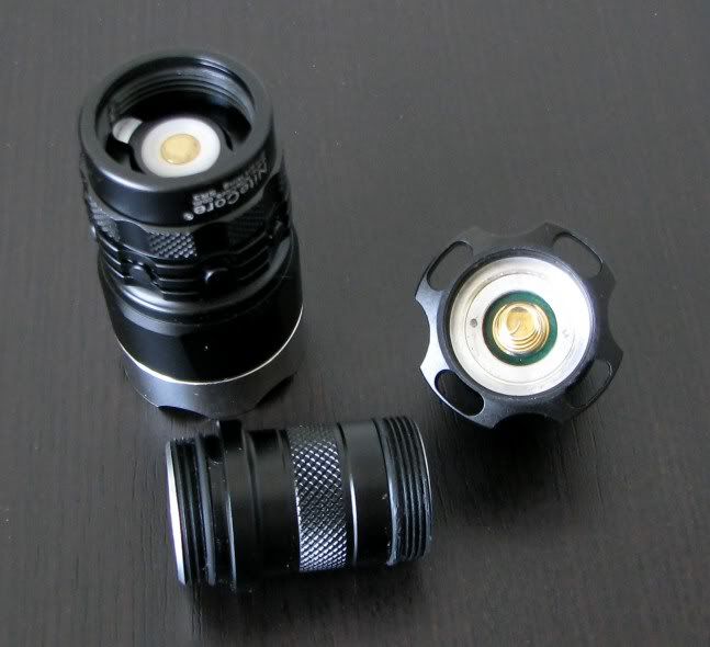

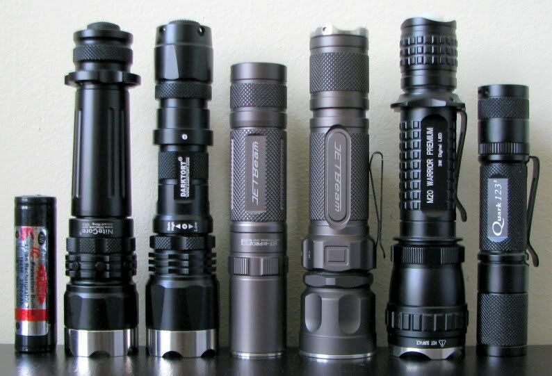

NiteCore intends to offer a 1x18650 extension tube for the SR3, and has sent me a prototype model to evaluate. Note that the final machining and design of the shipping version will be different from what you see below, but overall length should be the same.
From left to right: 1x18650, NiteCore SR3, Darktort DT-E1.0, JetBeam Jet-III ST, JetBeam Jet-III M, Olight M20, 4Sevens Quark 123.
Dimensions:
1x18650 body: Weight 124.5g, Length 139.0mm x Width 32.0mm (bezel)
Note the overall similarity to the Darktort light. Darktort is now known as the design testing arm of NiteCore, and the new SR3 appears to use the same reflector and bezel ring as the Darktort DT-E1.0. As you will see when I get into circuit performance and runtimes, the similarities are more than skin deep.

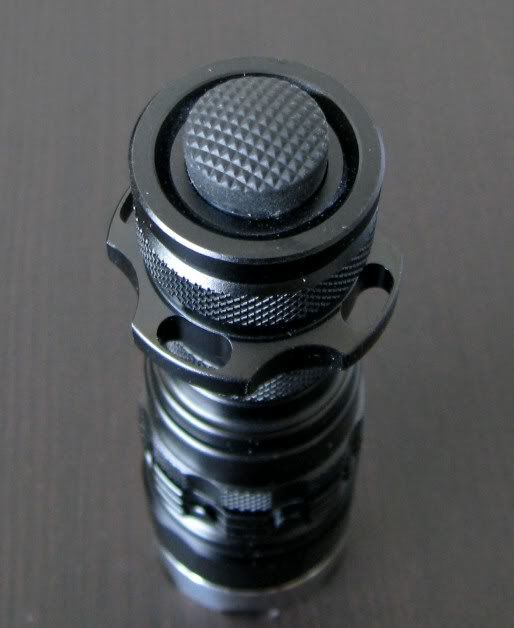

The clicky feel is very similar other NiteCore lights with a forward clicky (e.g. Extreme). Thoughtful of them to throw in a spare switch, given the well-known greater failure rate of forward clickies. Thankfully, this is one area where DarkTort design has not infiltrated NiteCore (i.e. the DT-E1.0 had a flaky switch with poor feel).

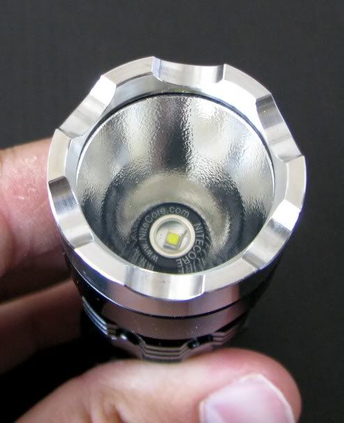

Fit and finish are excellent on my sample, no flaws in the type-III hard anodizing (glossy black). Body labels are thankfully kept to a minimum, although the lettering is not as sharp on this sample compared to some of my other NiteCore lights. Grip is certainly not an issue – in addition to reasonable knurling, the light has a large number of ridge details to enhance grip. The tailcap also includes a built-in grip ring. Note again that I do not know what the final design of the 18650 expansion tube will look like.
Screw threads are anodized for head or tailcap lock-out. The light cannot tailstand, due to the forward clicky.

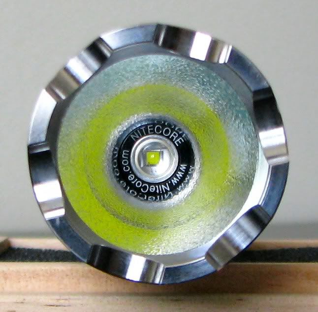

Note the NiteCore labels on the pill around the emitter. Despite how it may appear in the second pic, the emitter is perfectly centered (the reflection of the writing in the reflector may make it look otherwise). See the first pic for an angled shot.
The light uses the standard Cree XR-E emitter, currently with a R2 output bin. As you will see in my beamshots below, my sample seems to be a fairly warm "cool tint" (I'd guestimate WG tint bin). Obviously, there is bound to be some variability here – there is no guarantee as to what you would receive. For those of you not familiar with tints, please see my Colour tint comparison and the summary LED tint charts found here.

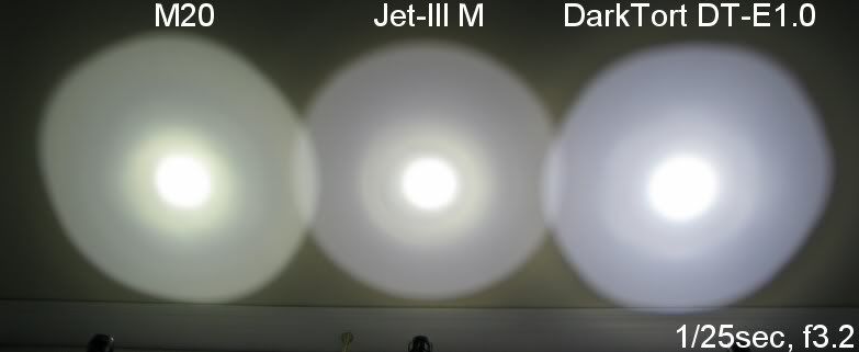

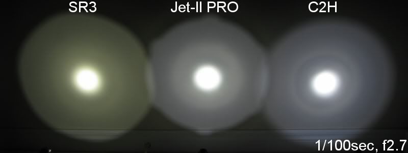

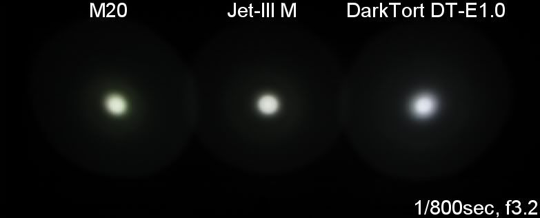

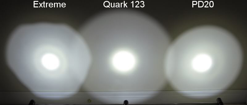

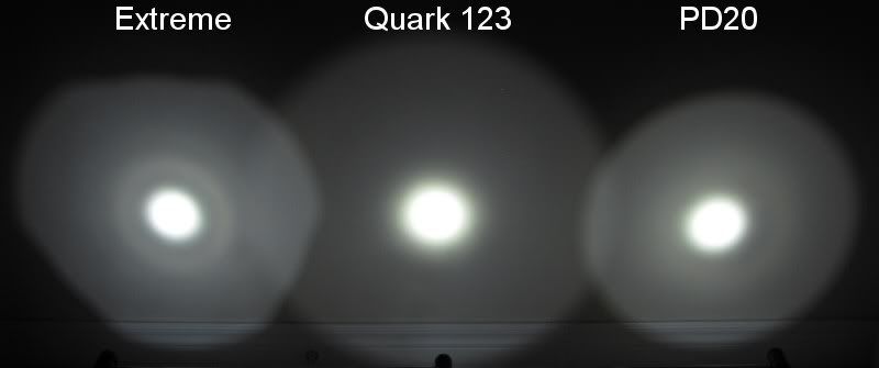

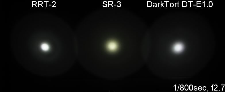

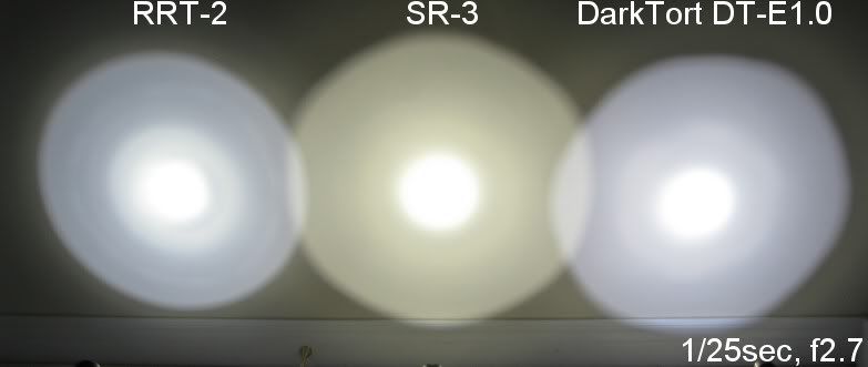

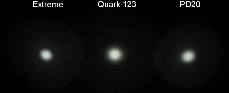

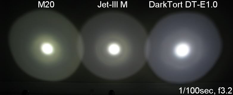

Comparison Beamshots
Note that I inadvertently set the camera to an f-stop of 2.7 for the SR3 level pics (instead of 3.2 for all the other). So that will make everything seem a bit brighter on that SR3 row.
In 1xCR123/RCR format, all lights are on 100% on an AW protected RCR, about 0.5 meters from a white wall.
In 1x18650 format, all lights are on 100% on an AW protected 18650, about 0.5 meters from a white wall.
The camera is accentuating the tint difference a bit, but the SR3 is on the warmer side of "cool white" tints, similar to my Olight M20 R2. Overall beam characteristics are fairly typical for a general purpose 2xCR123A light, with fairly good throw (thanks to its deep reflector) and typical width spillbeam.
This likely explains why the light is so large for 1xCR123A/RCR light – its reflector/head design is identical to the larger 1x18650 Darktort DT-E1.0.
UPDATE: Some additional long-distance beamshots, to show you how the light compares to others in its class.
Please see my recent 100-yard Outdoor Beamshot review for more details (and additional lights).

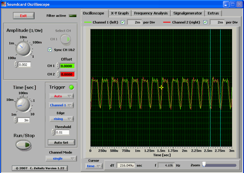

Pulse-Width-Modulation (PWM)
The SR3 uses PWM to create its lower output modes, but at a sufficiently high frequency that you will not be able to detect it without specialized equipment. I measured the frequency at 4.66-4.71 kHz from Min to Max on my sample (i.e. nearly 5000 cycles per second).
SR3 PWM
As I mentioned, strobe is at a "tactical" high level – 14.6 Hz in my testing. I certainly find it quite .
SR3 Strobe

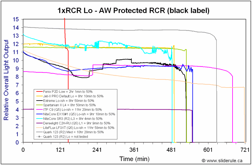

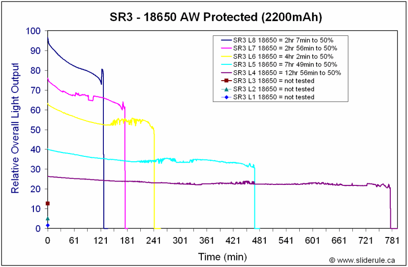

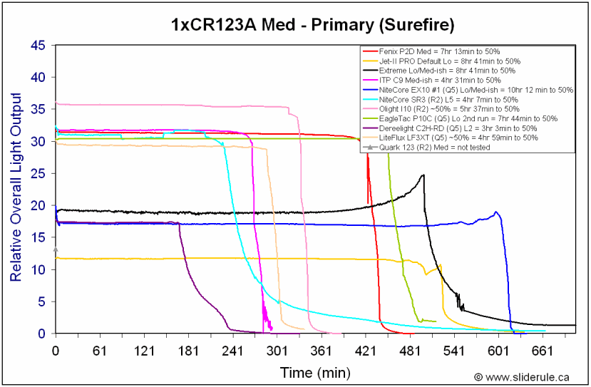

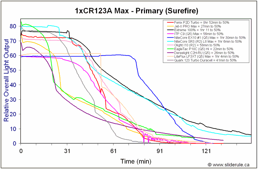

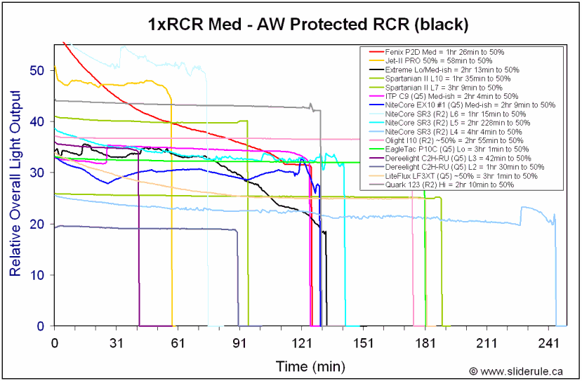

Output/Runtime Comparison:
As you can see above, individual output levels are well-spaced across the total range.
Runtime performance increases with each drop in output, as expected. The regulation pattern is a little uneven, with largely direct-drive on max on Li-ion (followed by a short jump before the battery regulation circuits kick in). The lower output runs seem a little ”noisy” (i.e. there are small fluctuations in output during the course of the run). But not to worry, these are not noticeable by eye – my lightmeter is simply highly sensitive and can pick them up.

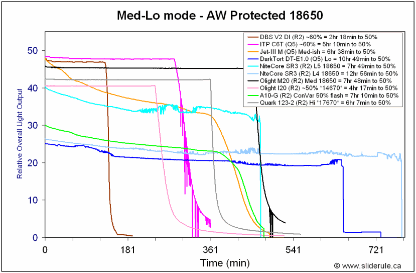

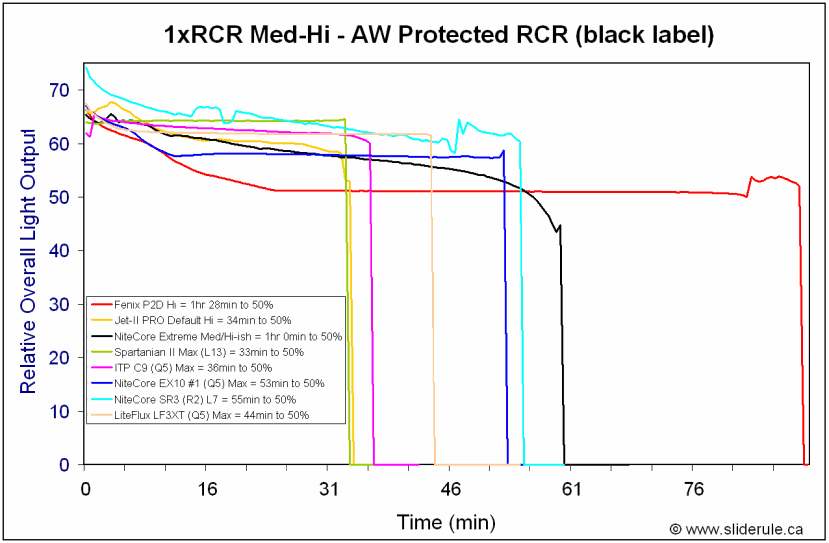

And now how the SR3 compares to the competition ...
Output/runtime performance is simply excellent on RCR – this is definitely one of the best performers I’ve seen, especially on the Med output levels.
Performance on CR123A is quite good, but doesn’t really stand out from most of the top-tier competition.

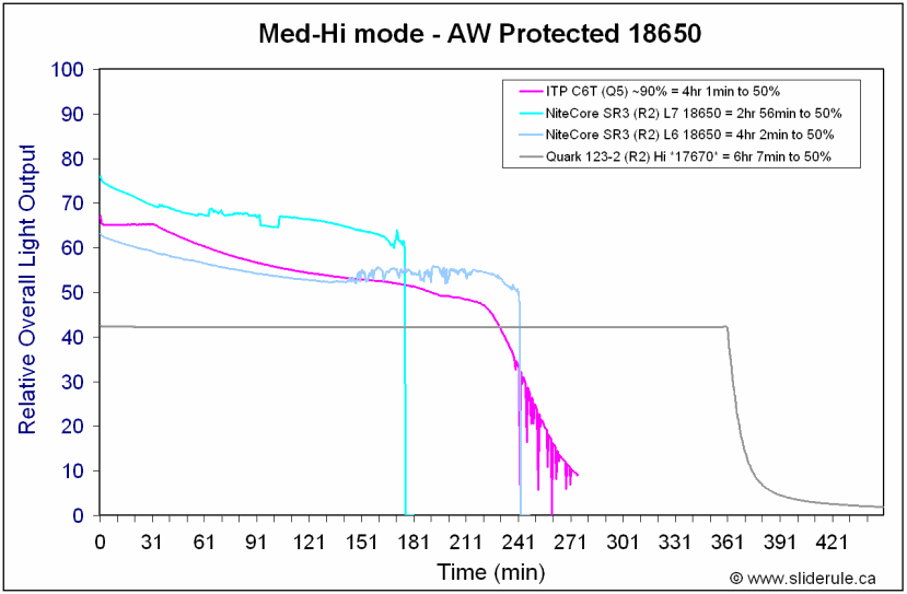

Now, what does that SR3 on 18650 Max output trace remind you of? Or the Med L4 trace, for that matter?
Basically, performance of the SR3 on 18650 on L8 and L4 are an exact match to the DarkTort DT-E1.0 on Hi/Lo. Output levels and circuit characteristics are identical.
